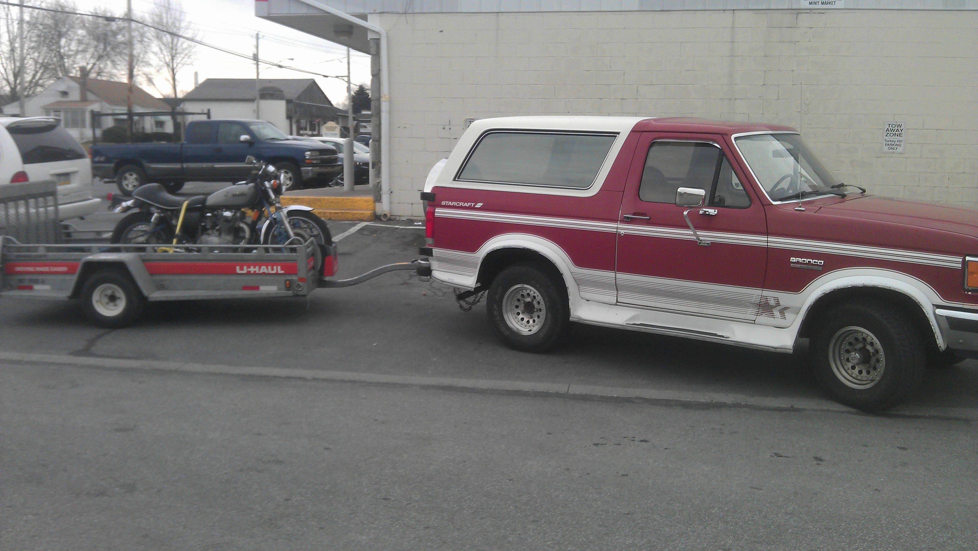

I recently picked up my first bike. I was debating about putting it in the back of my 94 as well. but after thinking about how hard its gonna be to put it up in the truck. The trucks got a mild lift with 32's nothing crazy but the bike wasnt light 550lbs. I checked uhaul and to rent there motorcycle trailer was only 15$ for the day. There was plenty of room left as well. Here is a picture of my dads bronco pulling it on the way home. It was just easier all the way around. Just another 2cents. I will tell you thou, that hauling my quad (raptor 660) in the back of my truck really doenst effect the highway speed as well. The truck is always slow.
