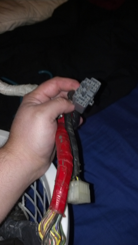

The two other plugs in cab that connect to chassis and dash harness well the grey plug that goes in the chassis harness is different other then that I could splice other connector on harness but idk about that her is pic of plug

Your making this difficult on yourself. A 91 22RE block is the same as a 94 22RE block. So, just use the 94 block and all your 91 accessories and harness.
I have a 88 with a motor I had 22repreformance build. I have no idea what year 22RE block is in my truck. But it's not a problem because I used all my original accessories and everything works perfectly.

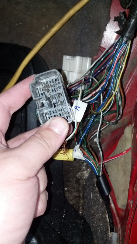

I bought truck like this and here is pic of plug its bigger then the wiring harness plug
