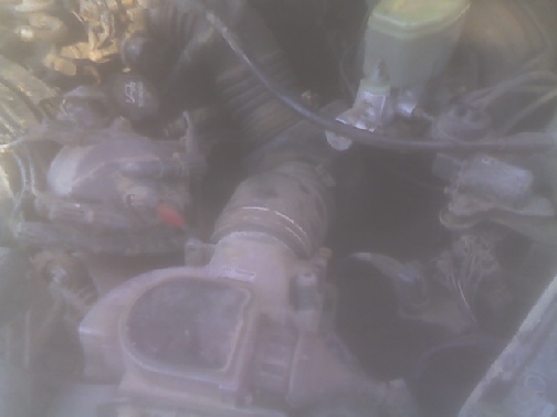

Could anybody point me to the location of the MAF sensor on 3VZ-E. I can't seem to find it. My reference comes from http://www.4x4wire.com/toyota/mainte...tenancep5.html

its the aluminum thing with the black top, its at the bottom of your pic, it sits on top of the air filter box
and its not a MAF on these engines its called an AFM

Thanks. I saw that but I thought that it had an AFM AND a MAF.... Sorry about that. Is it "cleanable" like a MAF sensor ?

i shouldn't be dirty if the air cleaner is doing its job, you can take it off and see if the flap inside moves freely thats about it

DO NOT take off the two little screws that keep the afm in and pull it out! you will break the connections and then you either have to solder all night or get a new sensor

you can clean the AFM.. mine was quite dusty (past owners not chaning air filters enough perhaps).. i just used a knife to cut the molding around the top housing and voila u can pop that cap right off.. Use an electrical cleaner and dont touch anythin with your fingers.. then i used an epoxy type stuff to reseal it up and hopefully she wont fail in my lifetime now lol

I did remove the two screws of the AFM and slowly started pulling and then I told myself "that ain't right" so I stopped, put it back together, went back inside, posted and got saved by Yotatech
