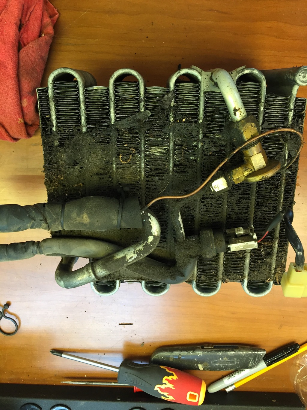

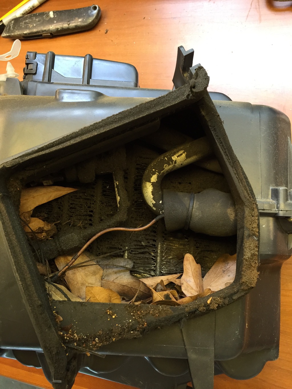

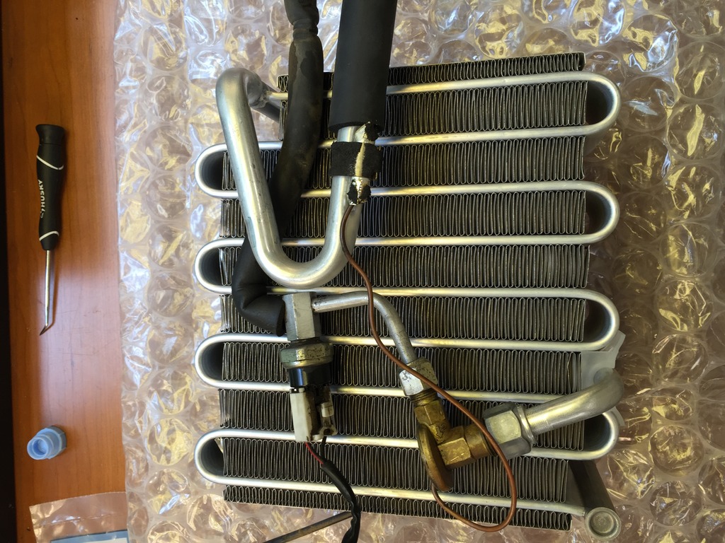

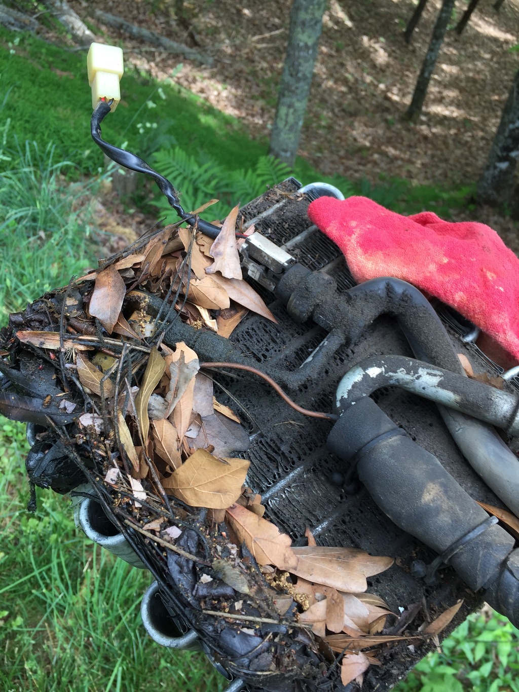

So I got the project done this weekend. I was amazed and how much crap had built up in my evaporator (pics below).
- After the swap, airflow was easily 3x
- The swap was pretty easy. I was worried that the evap would not pull out easily but it really does.
- Used a set of green HNBR o-rings
- I changed the AC receiver/drier at the same time.
- Going to get the system recharged today, hopefully it will be nice and cold.
As it was removed from the truck:
Removed from the housing:

Just used a completely new unit, with the accessories moved over onto it:
Old May 18, 2015 | 05:47 AM
  #24
scope103's Avatar
Joined: Sep 2007
Posts: 8,381
Likes: 873
From: San Francisco East Bay
Nice work. I think using a new unit was a good idea. The fins are fragile, and because of the bend are very difficult to clean inside.
