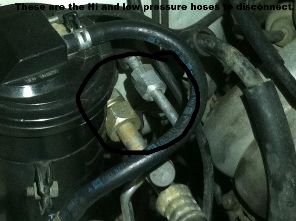

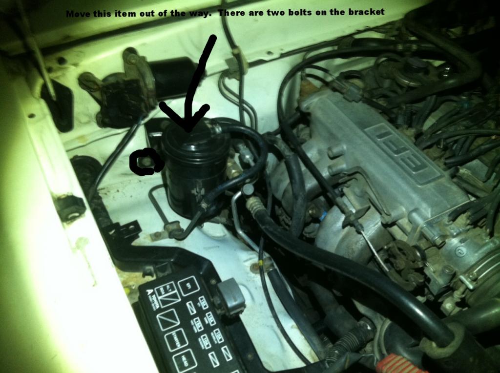

First I diconnected the High and Low pressure hoses closest to the firewall. I left them connected to the compressor. Once disconnected, I sealed them with some tape to prevent moisture from entering the system.

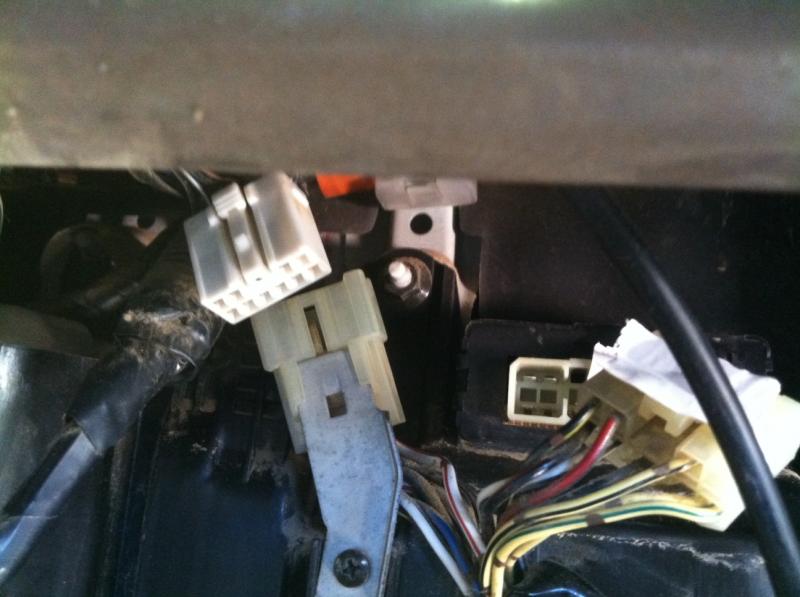

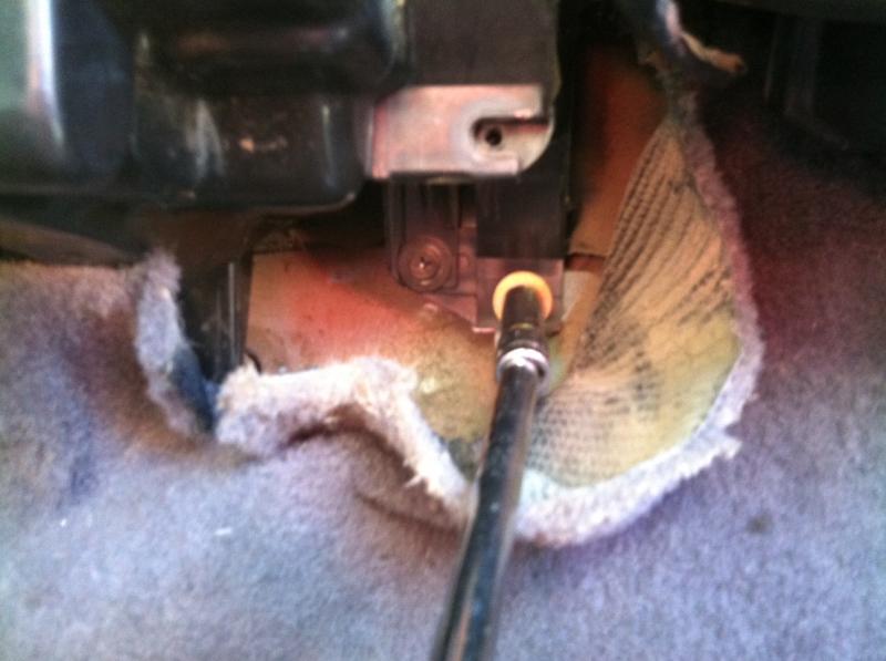

Next I started removing the screws that attach the evaporator to the inside of the cab. There are a series of 10mm screws surrounding the evaporator and one nut on a post at the upper left side of the unit. Also don't forget to remove the screws that are below the carpet. There are several electrical connectors to disconnect as well. I labeled mine just in case.

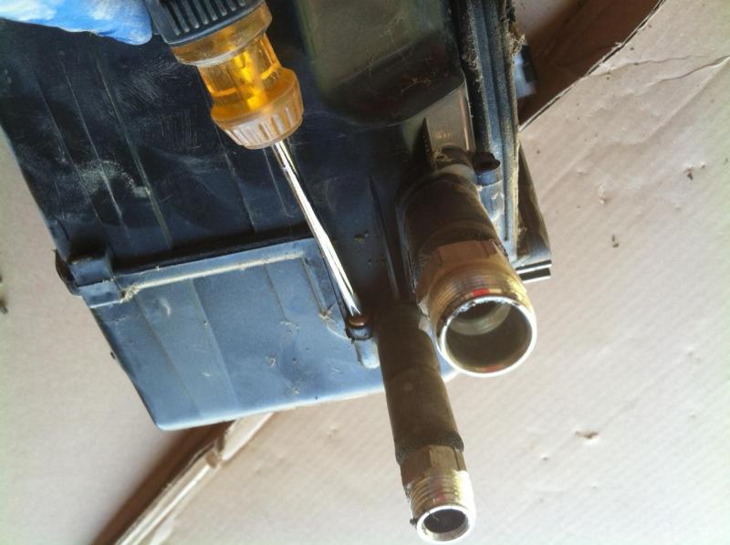

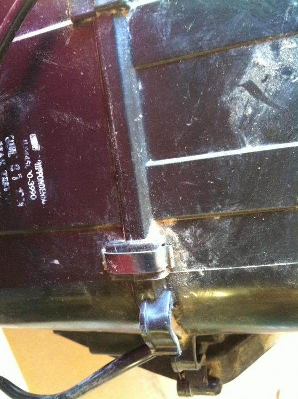

My evaporator came right out with just a couple gentle wiggles. Don't yank it out! If you get alot of resistance, you probably forgot a screw or the nut in the upper left corner. Once you get the evaporator out, It time to open the housing and remove the evaporator itself. There's a few screws and small clamps.

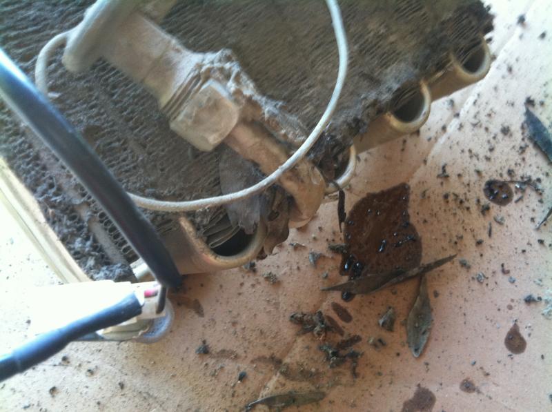

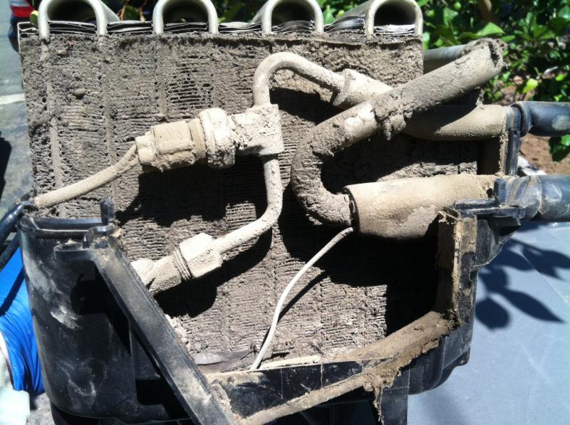

Yikes! Twenty years of neglect. I could tell as soon as I looked in the the housing that this was the problem.
Even some leaves made it down in there.
Another view

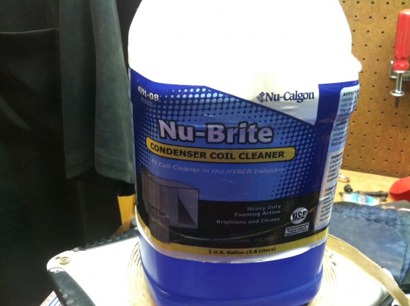

I used a cleaner that I saw on youtube. It was $25.00 from Grainger.

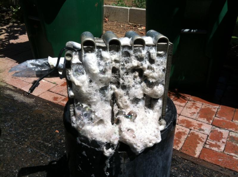

I followed the directions and the foaming action was incredible.
Although I bent some of the grids, It cleaned up pretty good after a couple rounds of the cleaner. I let it dry then reinstalled it.
Another view

PS Nu-Brite is not recommended for indoor use. http://www.nucalgon.com/products/coi...nsers/nu-brite It's for condensers (the hot part) not evaporators (the inside part). Calgon doesn't say why; could it have a strong odor?
