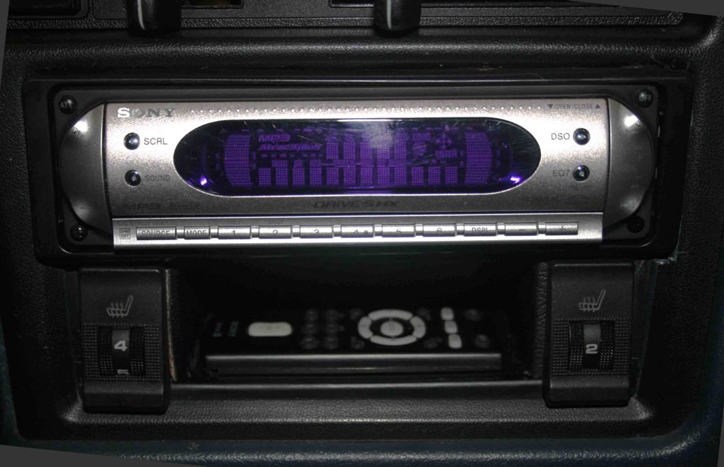

rustED, The Audi seats are holding up great but I must admit my 4Runner doesn't get a lot of abuse. It's my winter driver (while my '90 911 is off the road) and it usually doesn't get further off-road than the local ski hills.
wyoming9, When I installed the seats I did a custom install of the heater controls as well (see below the stereo in the pic). If I crank the heat setting up to max when I start the truck I get a toasty butt real quick!
Jim G.
Attached Thumbnails Looking for the MOST Comfortable  seats to swap in-console2.jpg

jgrant721: Very nice. Where/what did you wire the seat heaters to? If you could post some pictures of how they are wired I'd appreciate it.

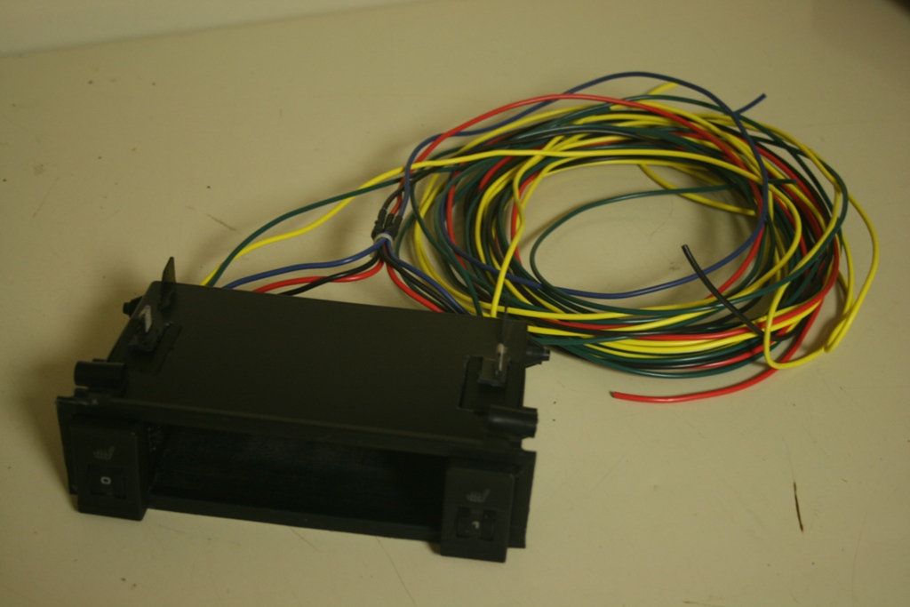

Nervo19, I found the correct controls for the seats on another eBay auction and then dug up an Audi wiring diagram that showed the connections to the seat. Here's a few pics that show some of the work:
Attached Thumbnails Looking for the MOST Comfortable  seats to swap in-wires.jpg   Looking for the MOST Comfortable  seats to swap in-plugs.jpg   Looking for the MOST Comfortable  seats to swap in-controls.jpg
I figured the Audi part came with the seat. I was asking what Toyota fuse you wired the seat controls to. Did you take any pictures of that? Are there vacant fuse places in the fuse box or did you do the add a fuse thing? What size fuse are they on?
Jgrant721
I am looking at doing something like this in my old 79 1st gen for those cold moose hunts up here in the Yukon
I have been trying to find what seats would be the easiest to wire in .
I have been looking at some vw Jetta seats as I can get them at our local wrecking yard .
I am unsure of wiring the seats in . Did you need anything else other then the seats and switch? Is there a module needed for the heated seats?
If you could do a bit of a wright up on the install that would be sweet. I've been searching all over and have came up with very little for info .

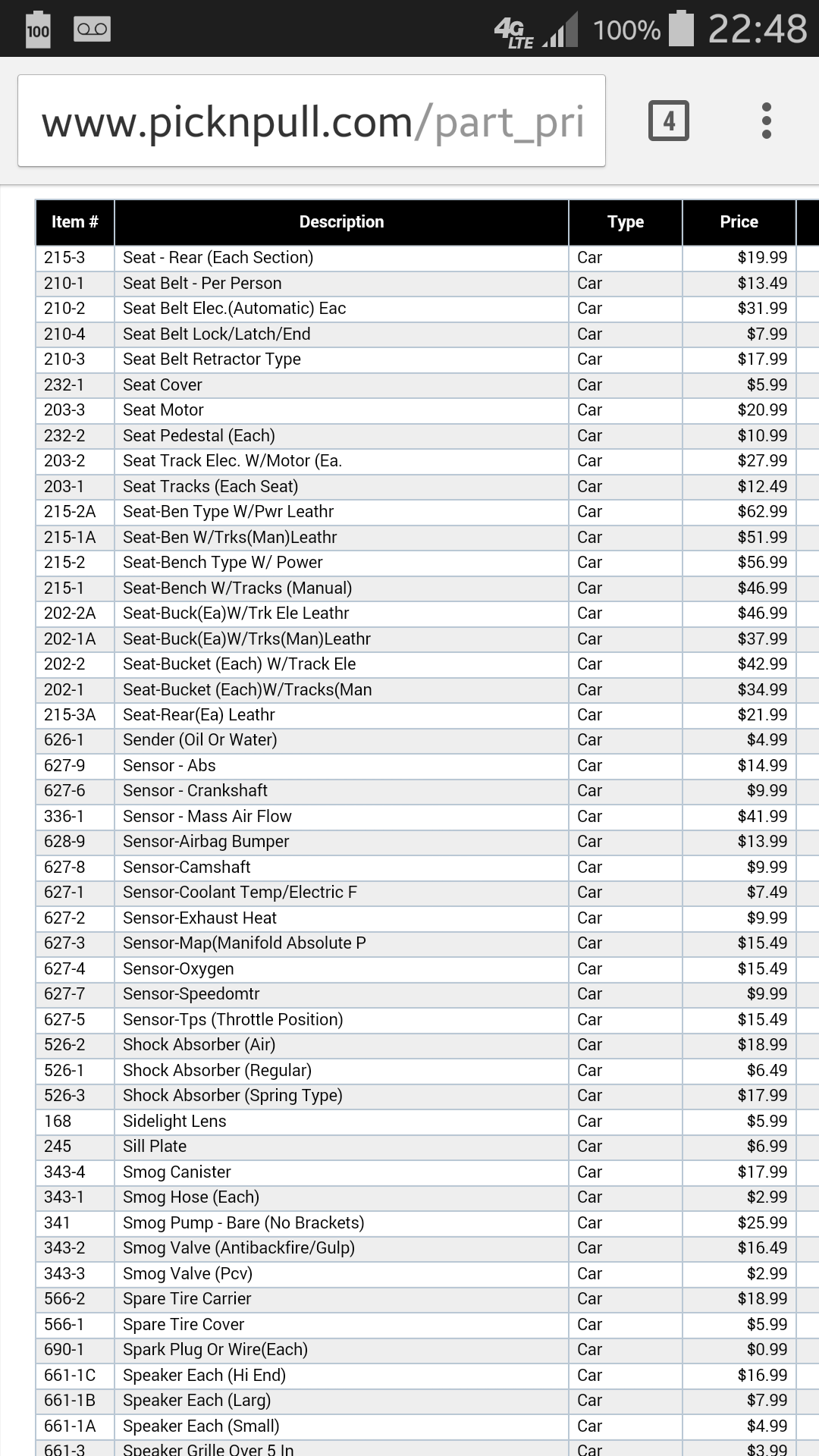

The Integra seats I had were practically bolt in for the front mounts on my 81. I am not sure about in an 84-88 (89 4runner). I had mounted a set of Prelude seats in my old 84 X-cab around 92, but sold that truck in 97 so my memory is a bit fuzzy on what I did.
To me $75-100 would be a good deal on a set of seats in great shape out of a low mileage car. Like I mentioned in a post above I got mine at a 50% off sale and paid $30'ish for the pair of prelude seats I currently have. I have debated about spending the money on a set of Mastercraft or Corbeau suspension seats since my back isn't what it used to be but it is hard to spend $600 +
I included a price list of what the local pick in pull charges for seats to give you an idea of real world prices
Attached Thumbnails Looking for the MOST Comfortable  seats to swap in-screenshot_2015-01-03-22-49-00.png

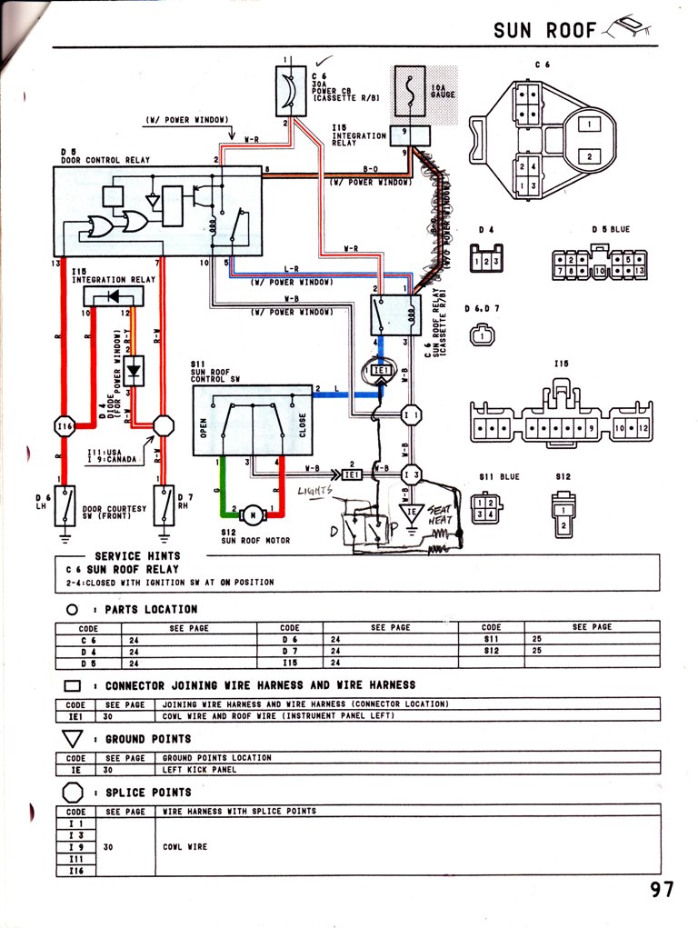

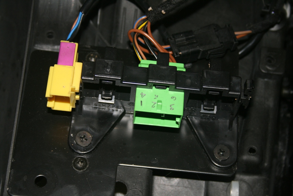

nervo19, I've attached a couple of pics that might help. The first is a page from the FSM showing the sunroof wiring. I don't have a sunroof so I tapped into the circuit at relay C6 (this relay was not equipped in the panel under the dash but I had a spare from some other work I did so I just plugged it in and it worked fine). The pencil sketch on the schematic shows a very basic idea of the circuit. Power comes from relay C6 pin 4 whenever the ignition is on. It goes from there to the two heater controls mounted under the radio. When they are turned on, power flows through the resistive heaters built into the seats and terminates at the ground point I3. It's actually a bit more complicated (as you can see in the second pic which is the detailed schematic I drew for the wiring install) because there is a second wire from the thermistor (heat sensor) in each seat to the control switch to tell it how hot the seat is. There's also more details on wiring in the notes. Hope this helps.
bushrider, There is some more detail on the install in the thread I referenced in my original post above. I would say that the level of difficulty of a project like this is really dependent on how comfortable you are with electrical (wiring /soldering) and mechanical (measuring/cutting/welding) projects. You should be able to buy some seats and matching controllers that will work but actually getting them to fit in the truck and look reasonably good requires some skills (or a willingness to learn and lots of patience!). I'm quite good at the wiring and soldering, not bad at the measuring and cutting and sadly lacking at the welding, but I took my time and it all worked out!
Good luck!
Attached Thumbnails Looking for the MOST Comfortable  seats to swap in-toy_wire.jpg   Looking for the MOST Comfortable  seats to swap in-toy_wire2.jpg

jgrant721: Thanks! I have a spare set of SR5 seats and was thinking about adding a seat heater kit from eBay. I've searched and no one ever shows where they hook it to power. Thanks!
