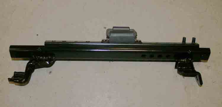

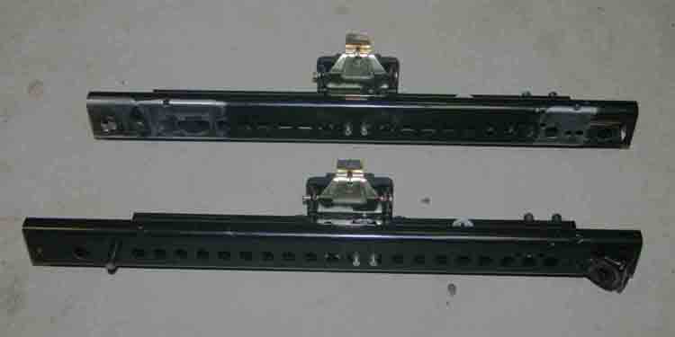

Seat Install Cont'd
Here's a few more shots:
- a before and after of the Audi seat rail which was shortened by 1.5 inch.
- a shot of the modified seat rail with the supports welded on.
