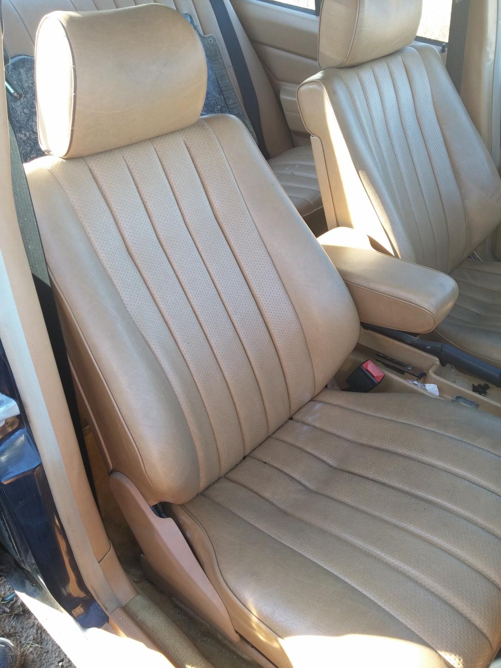

Seriously thinking about getting these seats from a Mercedes, they match the brown interior almost perfect, and they have a built in armrest on the driverside. Not to mention way more comfortable than my Subaru outback seats. Only $20 eachName:  20150116_145437_zpsh02lauza.jpg

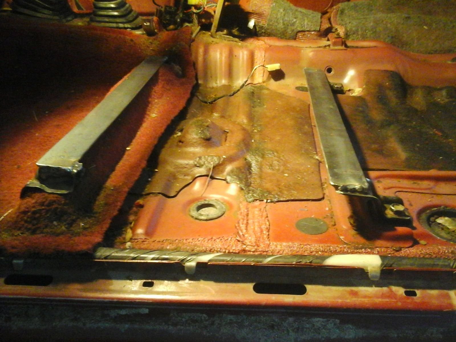

These weren't a direct bolt in. Here's what I did. First I removed this tall 2" bracket that added additional height to the seat that I didn't need. Here's a pic of the seats after removing the 2" tall bracket from the drivers seat, you can see how much lower it sits.
This is the one of the 2 brackets I removed from the new driver seat
Then I cut off and drilled out the rivets and removed the original floor mounting tabs from my original seat slider/tracks. After removing them from the original seats, I re-bolted them to the floor and welded some 1-1/2" wide by 1/8" thick flat bar stock to the seat tabs and made a new seat frame for the new seats to bolt down to. By doing it this way I was able to get the new seat centered, and still keep it low to the floor like the original setup. Here's some pics of the modified original seat mounting tabs welded to my home brewed bracket.
And here's some pics of the seat installed, still need to build a bracket and install the passenger seat.

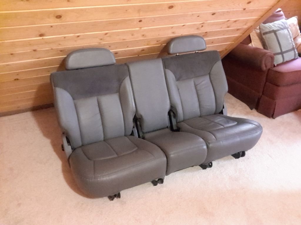

I also bought a rear split bench seat from the same guy out of a dodge durango for $85. The color match is pretty close to my front buckets.
