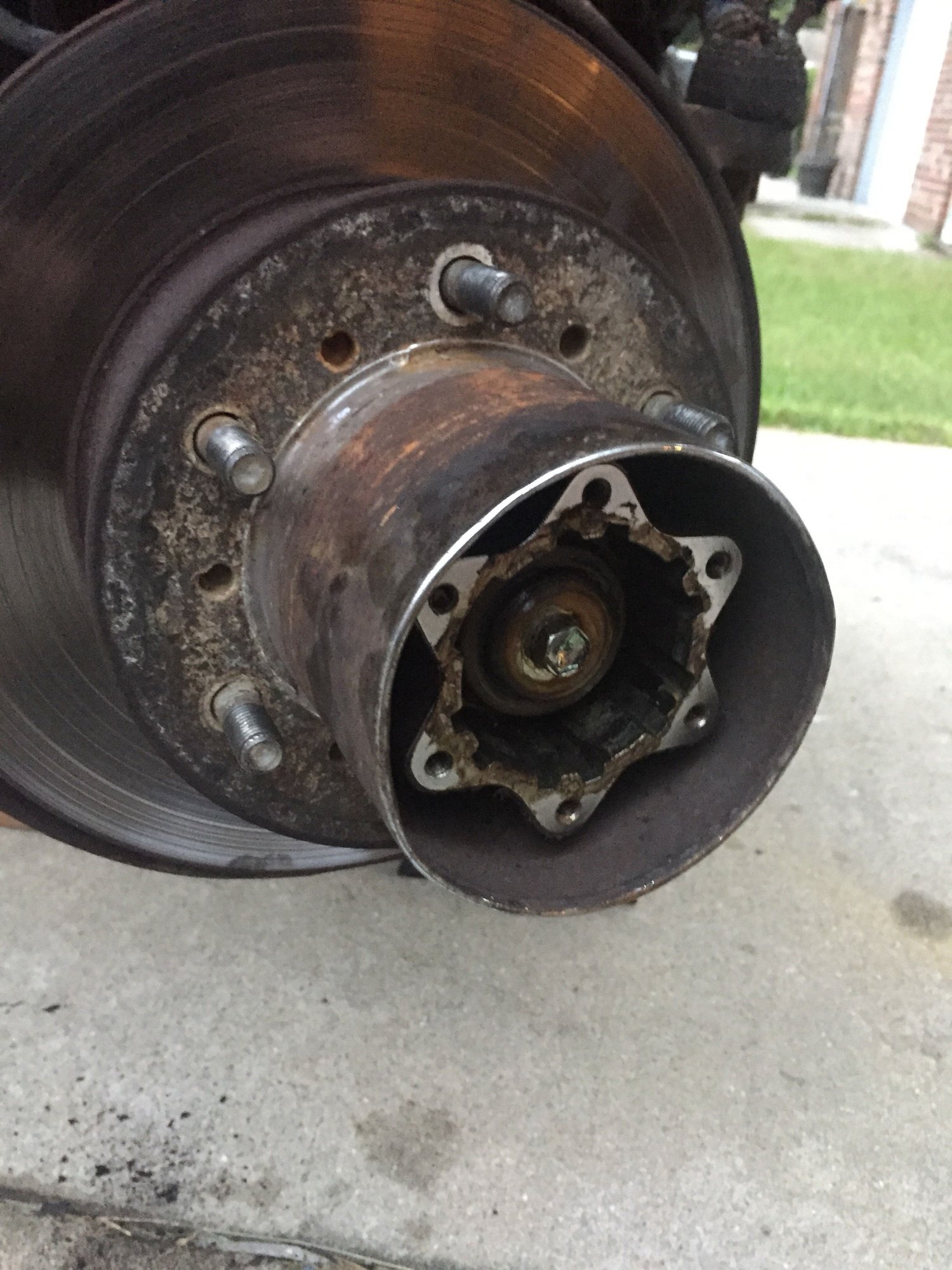

Alright, right off the bat I apologize but I have searched and searched and apparently I am using the wrong words to describe my problem. I keep finding dead ends or am unable to find my issue. So here it is, and thanks in advance, I'm sure it's simple I just have never encountered this.
I cant seem to figure out how to remove the outer guard surrounding the hub. any amount of hitting or tapping and it bends, any tips, tricks or techniques will be appreciated.

Seems like I had to cut down the outside and peel off. That outer part is decoration only and not toyota.

looks like an american racing center trim piece. use a thin blade screwdriver to pry under the edge at the disc. stuck due to galvanic action.

Penetrating spray of your choice get something in there to help free it up.
Then you can fight with the cone washers

That "guard" is an inner trim ring for an aftermarket wheel
Basically - its not stock and never was stock.
Its galvanic "welded" to the brake rotor.
Remove it
Cut it with a dremel or
heat it wit a torch
Drill a hole and pry
But "rip" it off and throw it away

Thanks everyone, you were exactly right of course, super simple and non important. I ended up cutting them off and trashing them.
