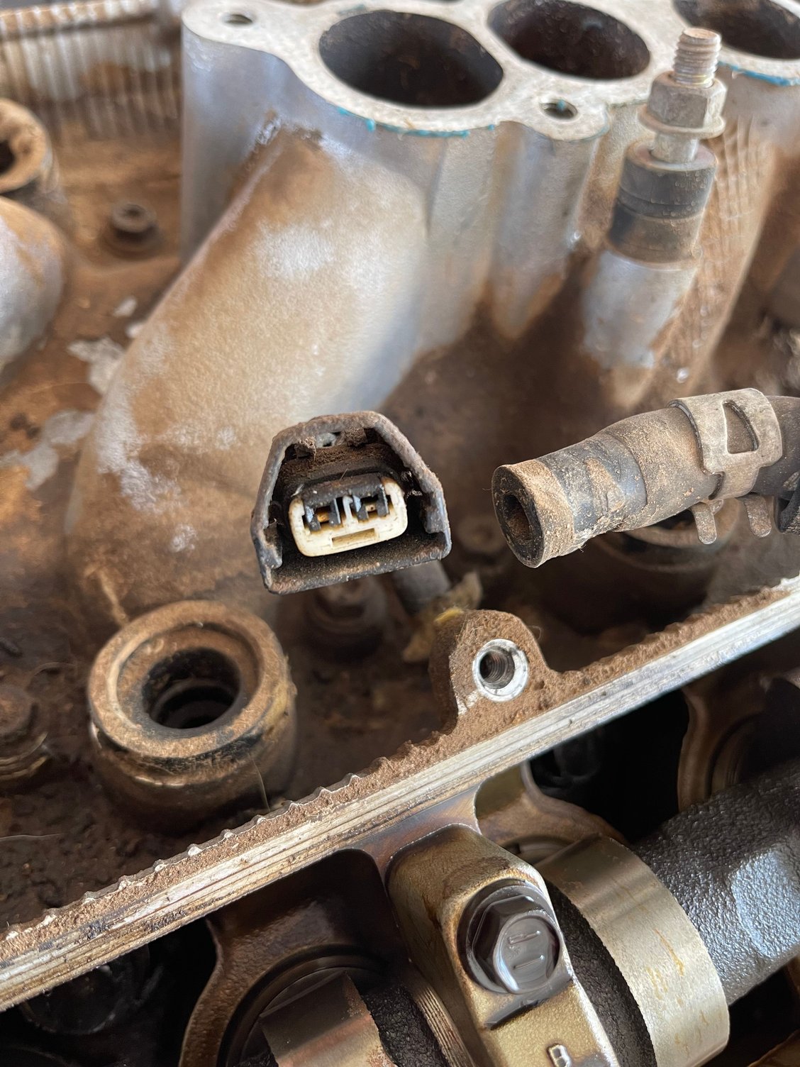

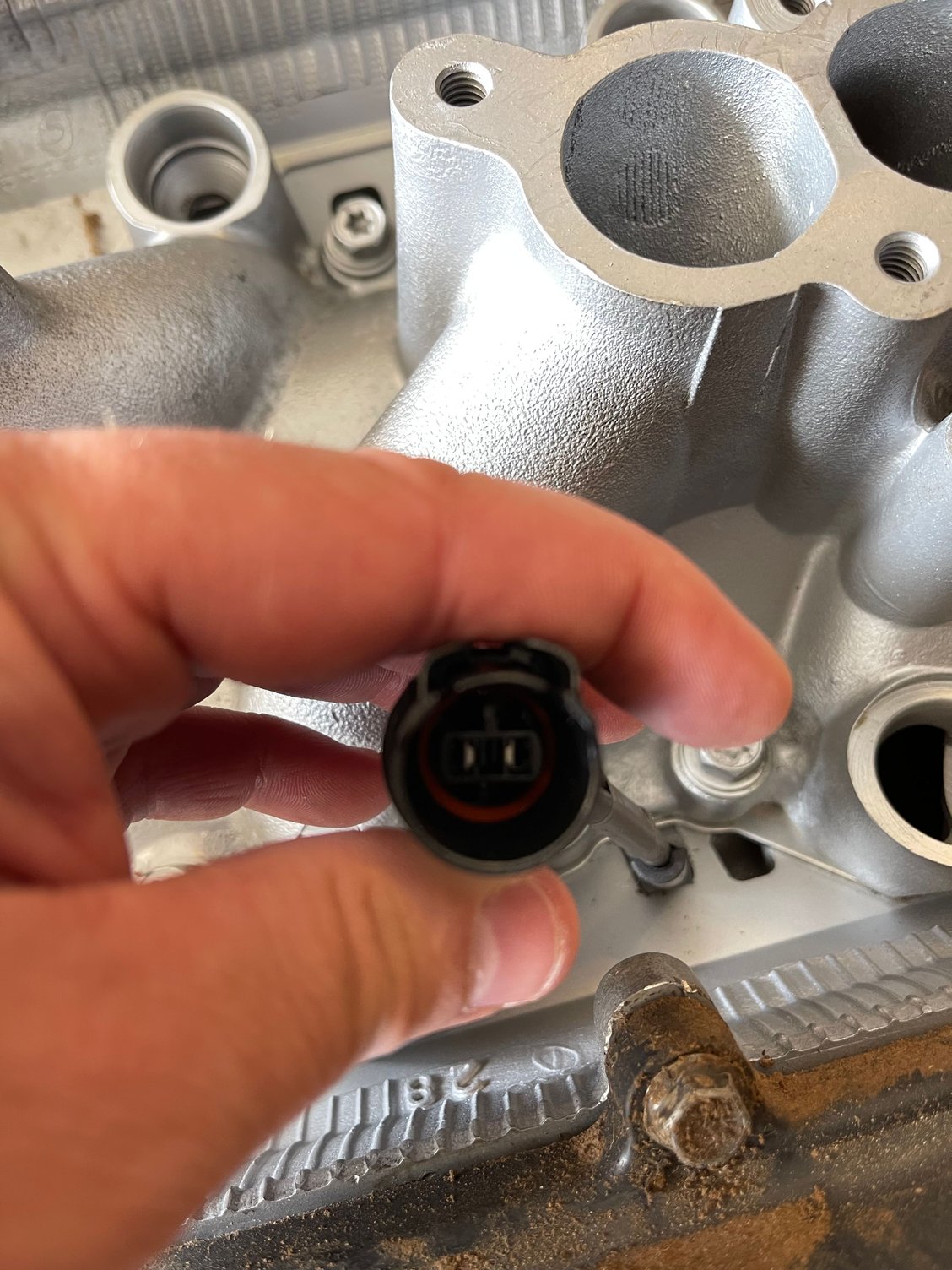

Recently purchased a long block motor for my 1992 Toyota pick-up. I just noticed the knock wire has a different plug on it after doing some looking it will work for years 88-91 not mine. Question is what is the main difference between the two? Can I simply cut and splice on different connector? Help is appreciated
Plug on my old engine
New plug

That’s a pretty sensitive wire. Did it come from a dealer? I’d check and make sure you got the correct one. If not from a dealer I’d recommend getting oem wire. Sensor, too. Such a terrible location to have issues.
removing the terminal ends from the connector would be a vastly better way to swap connectors than cut/splice, and that wire would be particularly hard to splice properly.

I don't recognize the round connector (but you might be right about the application). The correct wire (commonly referred to as the "pigtail" around here) is easy to get and not even very expensive. https://parts.lakelandtoyota.com/p/_...221935010.html
Amazon Amazon
The wire (on both sides of the connector) is shielded, so splicing it would be non-trivial. For the money, hell, just get the right part.
