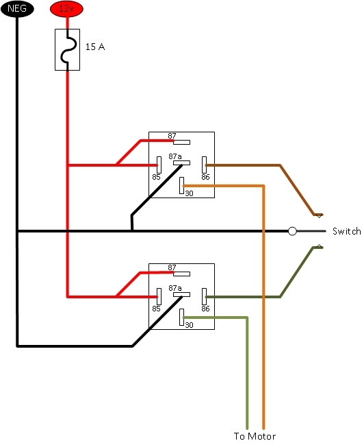

Originally Posted by irab88
i don't know what you're talking about...
besides, my truck has roll-up windows already. that means i would need entirely new regulators...
...like these
Was that literally all you needed for the power windows??
Old Mar 23, 2015 | 06:08 AM
  #88
irab88's Avatar
iTrader: (4)
Joined: Jul 2010
Posts: 6,499
Likes: 37
yeah, that bolted right in in place of the crank regulator. two wires to the motor (+/- for up, -/+ for down) and the circuit for the buttons as shown below.
it has 4 bolt holes, while the crank has 3. i used the same 3 bolts (omitting the 4th) in the new regulator and it works fine. i should have put in a 4th to be totally secure, but whatever
edit: cleaner circuit design:
