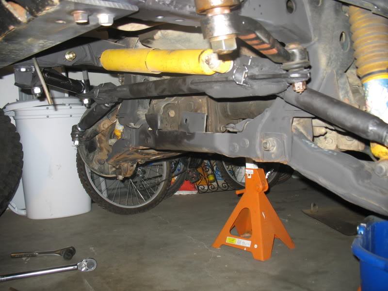

Not sure on that. I was unable to figure out how to do it, so I modified mine: I moved the steering 2" forward, using a stock steering box, and my TC idler arm. I then sleeved and braced the Relay rod with 1/4" DOM, and made new tie rods with 1/4" dom, and FJ-80 Tie rods.

If you use Heim joints, you should be able to leave the steering in the stock location.

Yes, Total Chaos is superior, just expensive. You can certainly run their kit. My solution was to upgrade by building it myself, with stronger, higher quality parts.

Stock pitman arm, stock upper and lower ball joints. The ball joints don't really get over flexed on early IFS systems, only the later ones (with coilovers). I just replaced them with new ones (old ones had 300k miles on them).
Really, Upgrading the tie rods and idler arm will do what you want. The center link is just a nice bonus.
