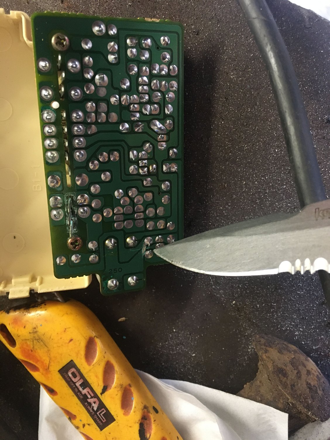

So,,had a pro take a look. There is no relay on 1991 model, regardless of what the manual say. Its a simple TWO wire horn. I learned the horn on driver side never worked. Someone had installed it and I traced the wires to where they stopped, not connected. During this I found the OE horn on passenger side which had corroded terminals. Had to cut wire back a couple inches as wire corroded initially poor ground. Replaced with a TWO contact horn from '12 caravan and all works.
While I was at it I decided time to KILL the warning buzzer. Removed circuit from back of fuse panel and cut trace contact with knife. No more buzzers. There is a thread on YOTATECH showing the simple procedure
