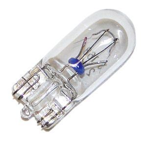

To be certain it is the horn, you can take a 168 or 194 bulb from your sidemarker or license plate light and bend the wires out to make a test light. Stick the wires inside the horn electrical connector and have a helper press on the horn switch on the steering wheel. If the bulb lights up nice and bright, you definitely have a bad horn unit. If the bulb is dim, or does not light at all, you have wiring issues (possibly in addition to a bad horn).
168/194 bulb, bend wires out straight to make testlight...
...Then get yourself a real testlight for future troubleshooting. It will make things much easier.
