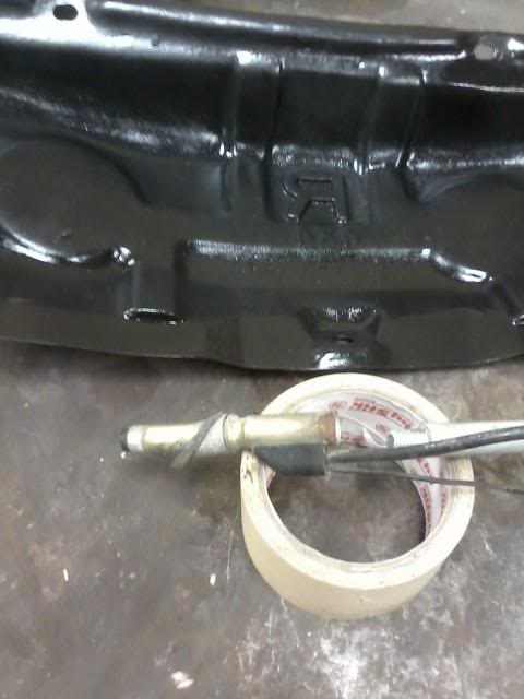

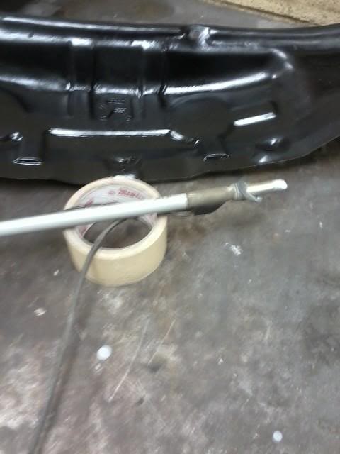

Below is how I fix my broken antennas. I cut the head off of a bolt and then thread the two broken pieces back together with the broken bolt. The castle nut holds the top of the antenna.
Copied...
Not the best picture, but in the top picture you can see the bolt in the top half of the antenna.
I just found a bolt that threaded into the two broken pieces and cut the head off twisted them together. I have done this before and it works great.
Broken

Twisted into one fixed piece.
