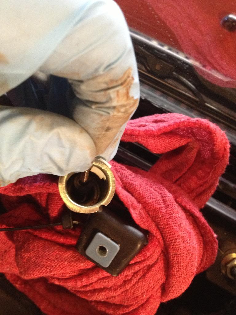

- Pull the cable up out of the sheath until the rubber seal unseats:

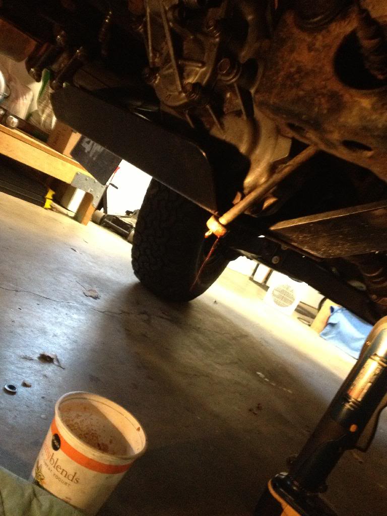

- Disconnect the bottom side of the cable from the back of the transfer case. Let it hang over a bucket.
- Proceed to squirt brake cleaner under the rubber cable seat. I was only able to get a small amount in at a time. It took a while for it to start running out the end, but it was pretty grody once it did:
- I found that I had to spray dozens of times before it began to piss clear. Probably used more than half a can of brake cleaner. The leftovers in the catch can were pretty nasty:
