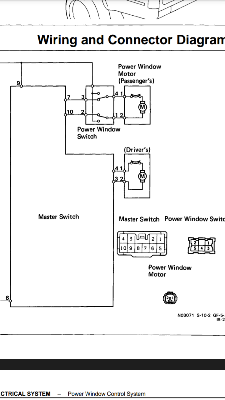

If you want to keep more of the stock components, here's the schematic: http://web.archive.org/web/201102052.../7powerwin.pdf
(The door lock control relay allows you to operate the windows for a few seconds after key-off.)

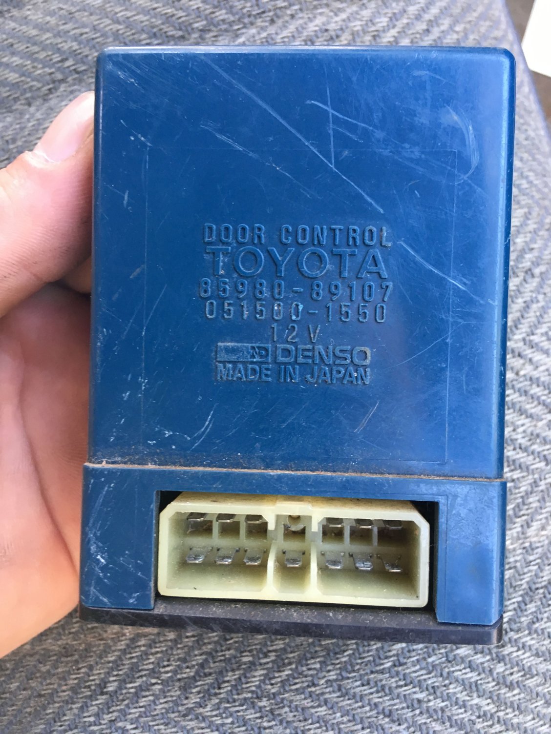

Ok I see I did find a Door control box

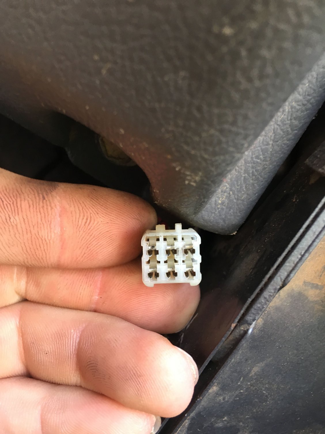

This is the connector coming out the door that I put a power wire and ground wire too make it fuction. The door is complete . So what y’all saying is that it would need another Switch? Lol..

What they said was to put the factory wiring in it...
You need to connect the (master control) left side to the (slave/passenger) right side.
Master pin seven to slave pin three.
Master pin ten to slave pin Two.
Master pin nine to slave this is power input, I believe on pin five.
You'll need to trace the wires from that door connection to the window switch to find out what goes where inside the passenger door.
