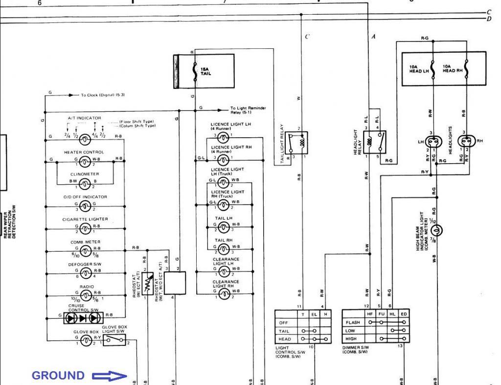

Your intermittent problem and high-beam indicator coming on while low-beam intermittently turns off point to the low-beam contacts. on the dimmer-stalk-switch. Do as Terry did to make sure contacts are clean and in good condition.
How does this happen?
When pins 6 and 13 of the dimmer-switch-stalk lose contact:
1) low-beam filaments lose ground so they turn off, AND
2) positive side of high-beam indicator gets12V through the low-beam filament so indicator comes on.
Schematic is here:
