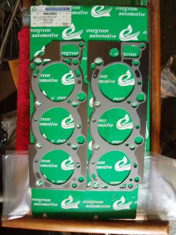

I have Rock HGs on my 3VZE now. And have ran them for ~11k with no issues. However, the fire ring is integral to the Slipperplate™, unlike the head gaskets shown in the previous posts.. There's also more interesting data on 22re HG failures due to poor/inaccurate HG design in my HG thread here. https://www.yotatech.com/forums/f123.../#post51227206
Notice the fire ring, or lack there of on these HGs for the 3VZE.
BTW, that Victor Reinz HG looks VERY much like the factory original that took 215k+ miles to blow on my 88 3VZE. No Slipperplate™ unlike the HGs installed during the HG recall campaign for the 3VZE. So it was highly likely the original, definitely never had the recall done atleast.
See. Fire rings on the older, pre-Slipperplate™, HG designs.
So you could be onto something there. I wonder if Victor makes HGs for the 3VZE like that anymore?

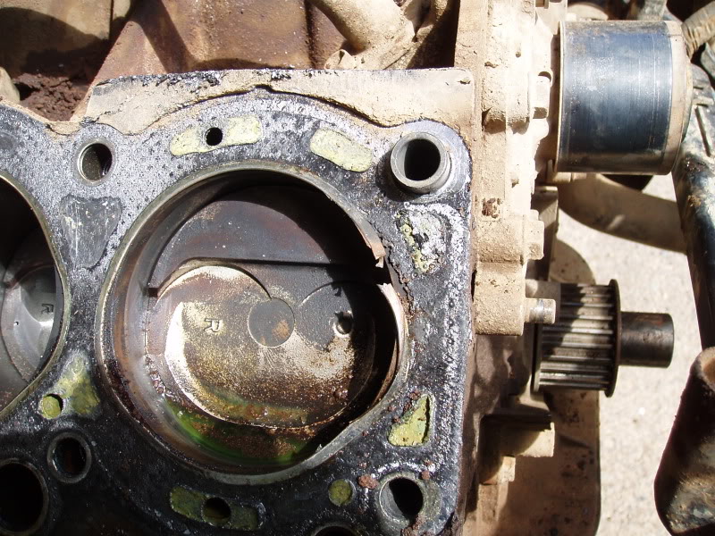

I have had TWO Rock headgaskets fail in the last 3 years.
Both were on completely rebuilt 22RE's, with new head bolts torqued correctly, and no shortcuts taken whatsoever on the rebuilds. All machine work was professionaly done.
Both failures were with the slipper-plate design. The first completely blew out 7,000 miles after the rebuild, and the second just started pushing exhaust pressure into the cooling system with 13,000 miles on the engine.
I have since switched to Fel-Pro head gaskets, and have had ZERO issues.
