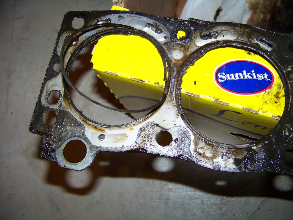

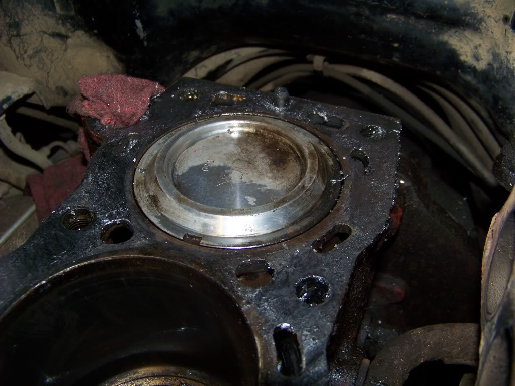

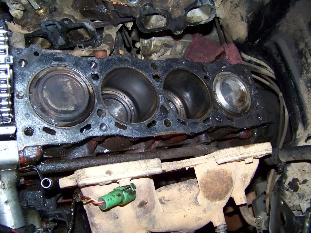

Just saw this thread while looking for some info on cleaning the block for replacing a head gasket. I rebuilt my engine 25000 miles ago and have a blown HG. I rebuilt it using a rebuild kit from Ted, all Rock Auto parts. I don't think the rings on my pistons have ever seated properly, trucks runs fine but have alot of blowby and compression is all around 125. The HG blew last week on the #4 piston.
Probably going to spring for OEM HG kit, don't want to have to mess with this again in another 25k. As for the blowby, that may just force me into a 3RZ swap!
