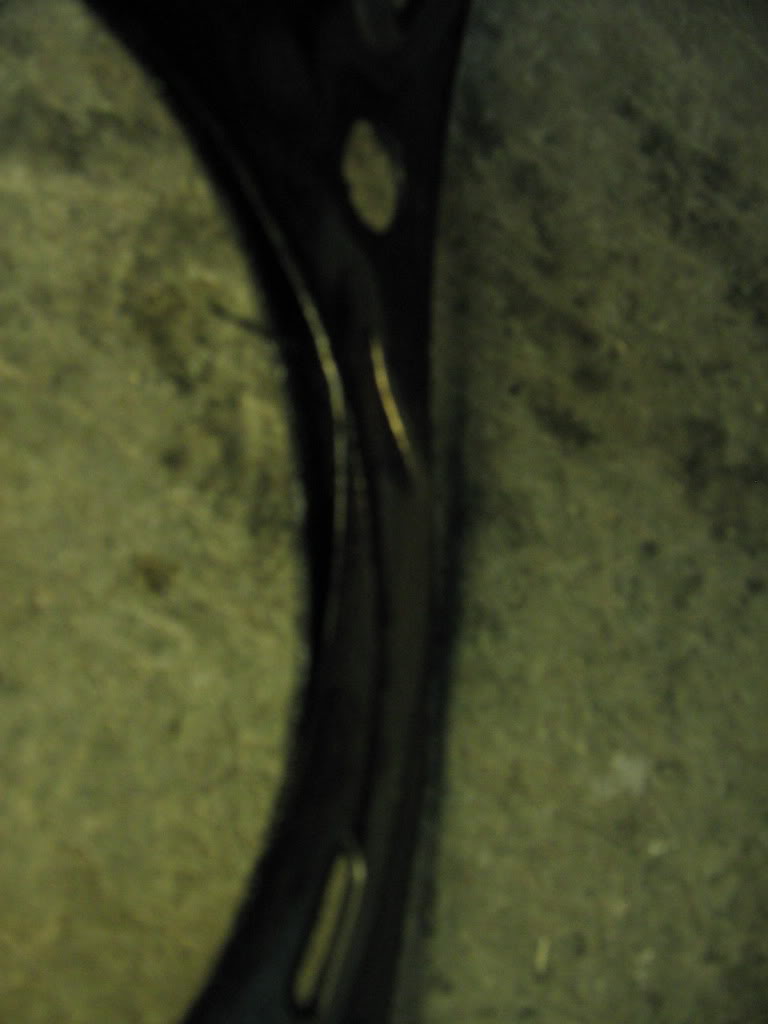

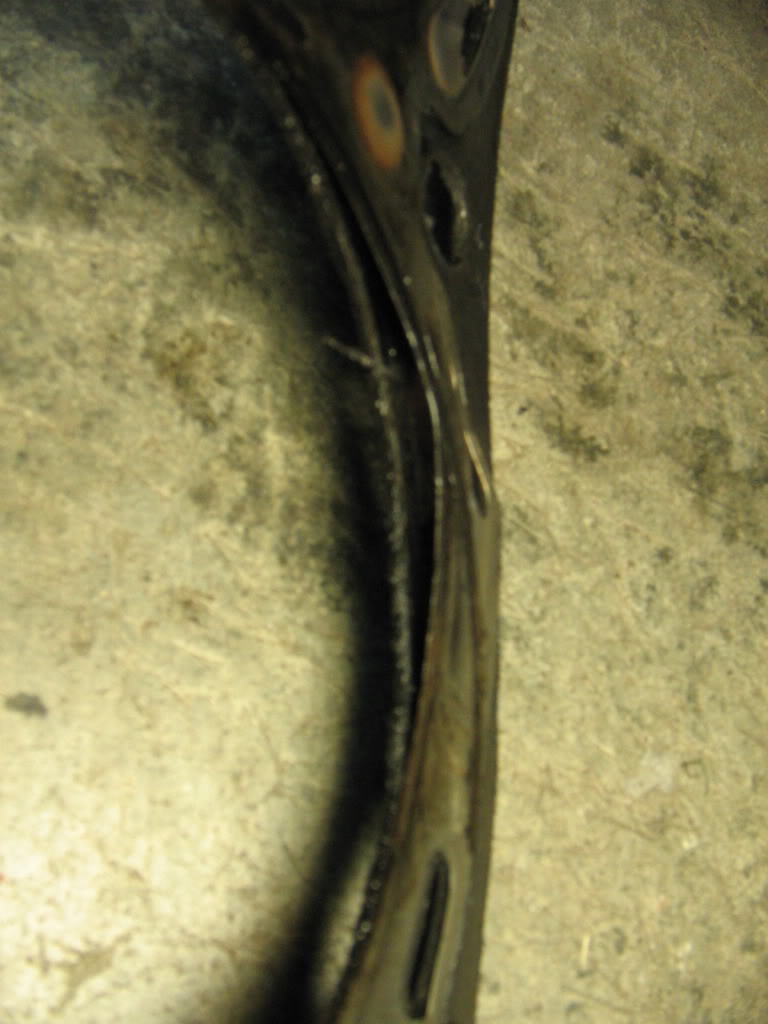

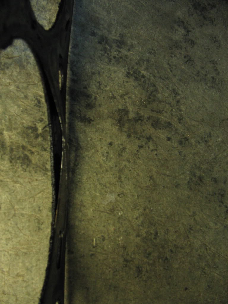

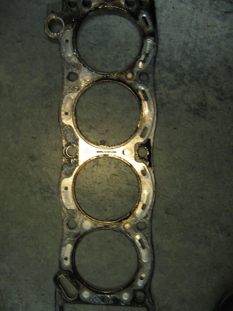

I pulled a part an engine that I had installed into a customers truck.
Fully rebuilt with proper surface finishes for graphite type head gaskets. All threads tapped. Full D&J Rock Products kit
New ALTROM head bolts were used. The initial torque was set to 65 ftlbs. The customer brought the truck back for his initial oil change, head bolt re-torque, and valve adjust.
7 thousand miles later it sits in my shop after being swaped out to take care of an oil consumption issue.
When I pulled the head this is what I found.
The fire ring is one piece. Meaning it is "rolled" from front to back as one piece. When the gasket is crushed it is only supposed to pinch and stay intact.
Many times after years of service you will see a "split" head gasket, they often will still seal but it is definatly a precursor to blowing.
One of the fire rings had already split. One other rebuilt engine that I tore down had done this as well.
It's interesting this other issue is causing me to tear down engines that otherwise would never have been torn down. So a lot of R&D is going on here. It's interesting to see wear or issues that will become problems later in an engines life. Obviously most people don't tear down a freshly rebuilt engine.
When a person goes in and talks to a shop they get answers about parts based off that persons likes and dislikes, hopefully experience based. And you just have to trust their judgement.
I was told by an engine rebuild company who ships quite a few 22R/22RE engines that he has seen many premature headgasket failures with most brands of headgaskets. Keep in mind this is a shop so we are talking about fully rebuilt engines. He said he seems to have solved 99.9 percent of these problems by going with a Victor gasket. There is always someone who reuses an old water pump we can't help those type of people when that pump causes an overheat and makes a gasket fail.
Anyways, what are your experiences? Anyone loose a headgasket shortly after a full rebuild?

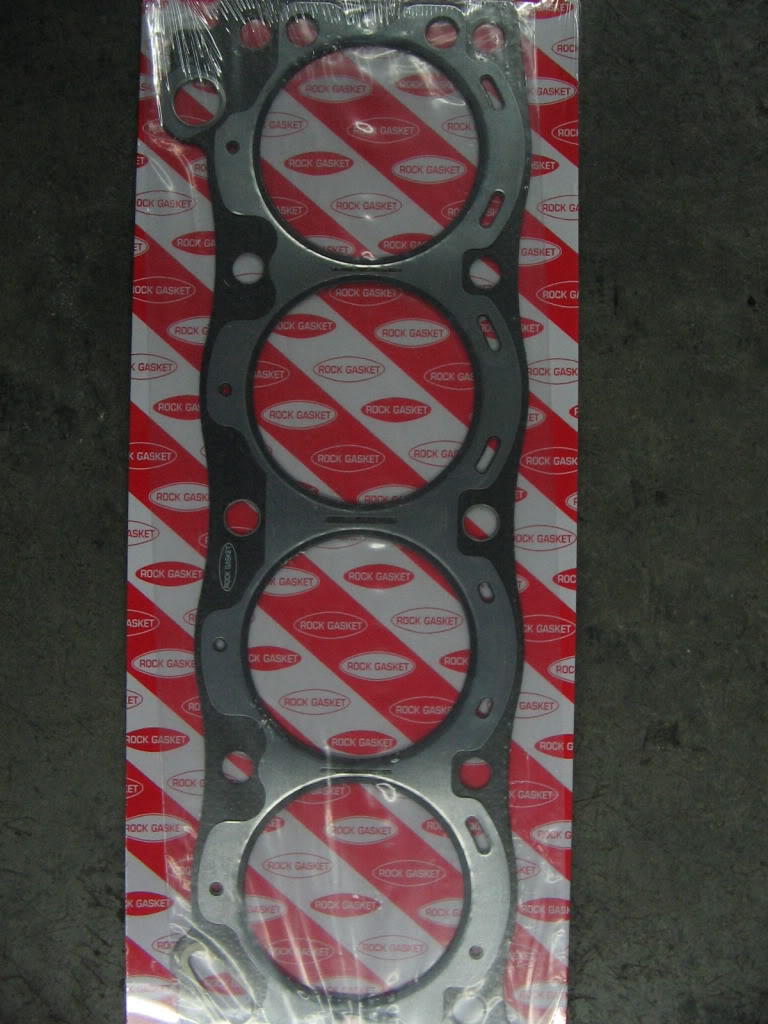

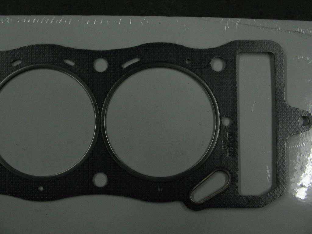

Some pictures: Notice the VERY different design from the Rock HG

That HG looks goofy. Semi-crush, semi-(ML)Steel. I would NOT trust that thing to crush uniformly and seal correctly.

That gasket looks eriely familiar to this one doesnt it?
http://cgi.ebay.com/ebaymotors/1985-...Q5fAccessories
$32 shipped isnt bad if you are just in it for the other gaskets and seals.
Stick with known brands if you are going to rebuild your engine. How much is your time worth taking everything apart to replace that sh-tty rear main seal, clutch, headgasket, valve stem seals, or bearings because it was cheaper initially? How about a snapped timing chain that destroyed your head and you're stuck 25 miles into the trail?
