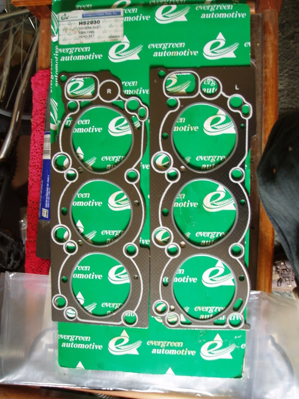

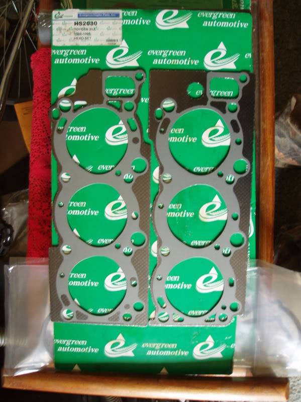

I recently purchased, off ebay(of course), these incorrectly designed look-alike/upside down/counterfeit head gaskets for an 88-95 3VZE. They were in a head gasket kit/set like these:

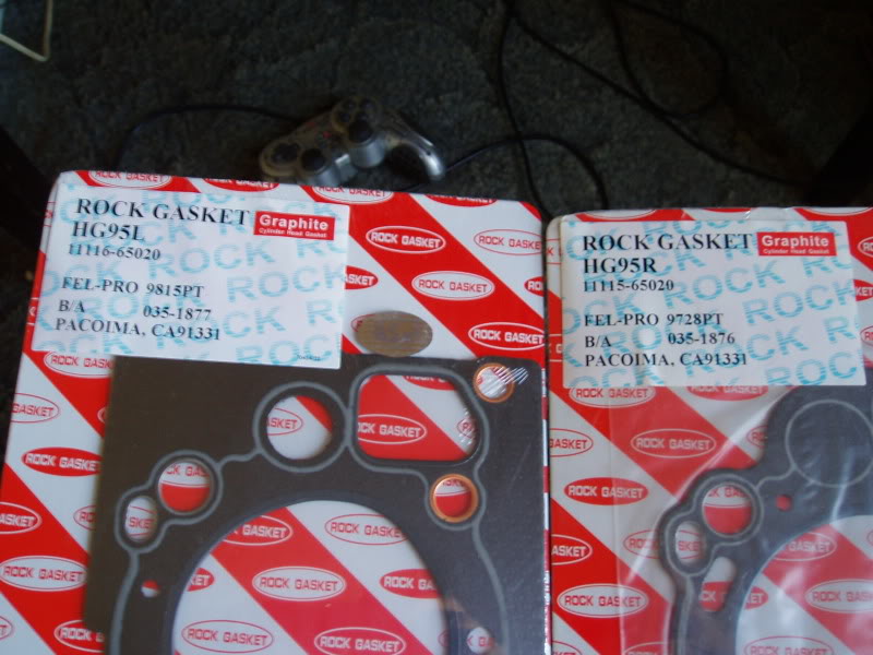

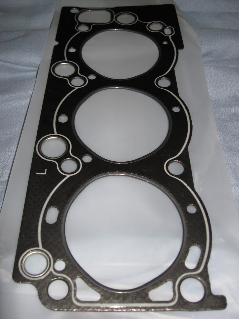

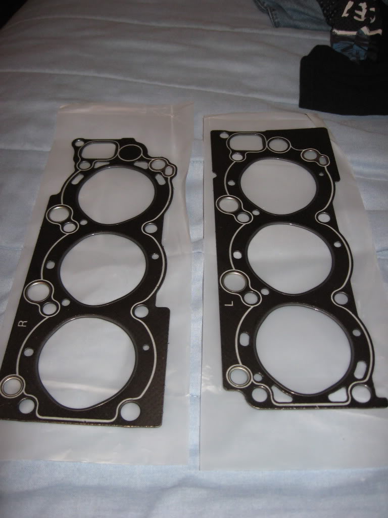

If you compare them to the correct style, you'll easily notice what I'm refering to. Here's some I purchased a few days ago that are identical, in construction, to all the 3rd generation 3VZE head gasket designs currently distributed by true OE quality parts suppliers("engineered" by ENGNBLDR, thanks, and your welcome, Ted). They are made by D & J ROCK PRODUCTS, INC. as ROCK GASKET® part numbers HG95L & HG95R, and are equivalent to OEM part numbers 11115-65020 & 11116-65020, Fel-Pro part numbers 9815PT & 9728PT, and Beck/Arnley part numbers 035-1877 & 035-1876.

NO!!! YOU CAN NOT JUST FLIP THEM OVER!!!!
For one thing, they won't fit if you flip them over(tried). For another, the opposite side of the gasket is not the same. And the graphite/white silicone side must face the block.
The other side faces the head. It's the Slipperplate™ side. See below.
