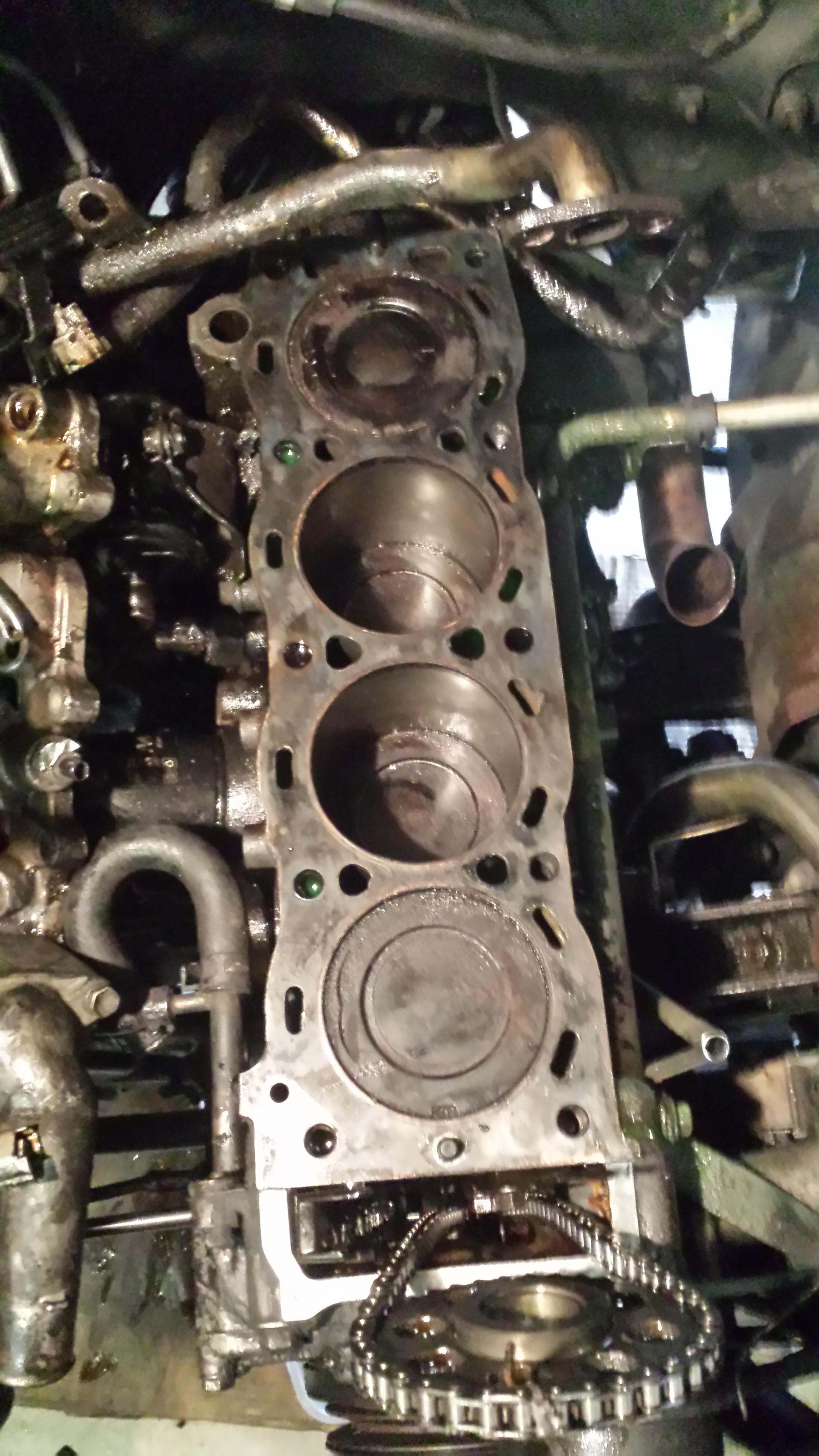

Am I looking okay?

Looks fine to me, but I just took apart the nastiest 22r I've ever seen. So I might have shut off my "oh ˟˟˟˟˟, that's broke too" vision. Lol

I did mine about 2 weeks ago. Looked exactly as yours. Now it's like a new engine; it runs really good. I'm sure yours will also. Good luck

After further inspection I found that my drivers side timing chain guide has broken off.

looks good.. I would make sure to wrap a piece of square tube with 100 grit sandpaper and carefully run it over the top of the block to get a good clean bite on there. The square tube keeps a level surface as you sand. Put some paper towels down in the cylinders. ALSO and very IMPORTANT.. get a shop vac and an arrow. Cut the arrow in half so you have a hollow tube. Affix the arrow to the end of your shop vac with tape so it sucks air through that tube. Stick that tube down in each of your cylinder bolt holes to clean them out. You will be glad you did. After all that is done pour some rubbing alcohol on a paper towel and clean the top of the block until you are blue in the face.
May as well convert that thing to Dual Row while you are in there You'll never have to monkey with that timing chain again.

Run a tap down the head bolt holes after you clean them out.

X2 on tap, or a use an old head bolt and dremel to improvise. Really like the arrow trick.
