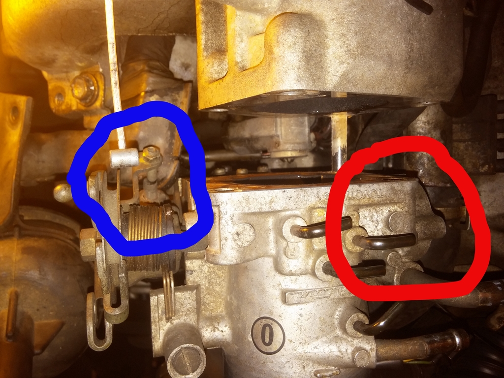

hey whats guys...now before i start with my stupid issue, id like to make it clear that i indeed did search prior to making this thread and im looking for verification and clarity more so then a "how-to"... so anyway without further ado. i have a 1993 toyota pick-up with the 22 RE engine. i have frankenyota's tps adjustment walk through as well but it seems i cant get my base line to start adjusting. my engine/TB seems to be a late model design just based on the horizontal positioning ive seen in the 22RE variations. the pictures well further elaborate.
in the first photo my tps is NOT on the throttle body (red circle) and the throttle is obviously closed indicated by the blue circle

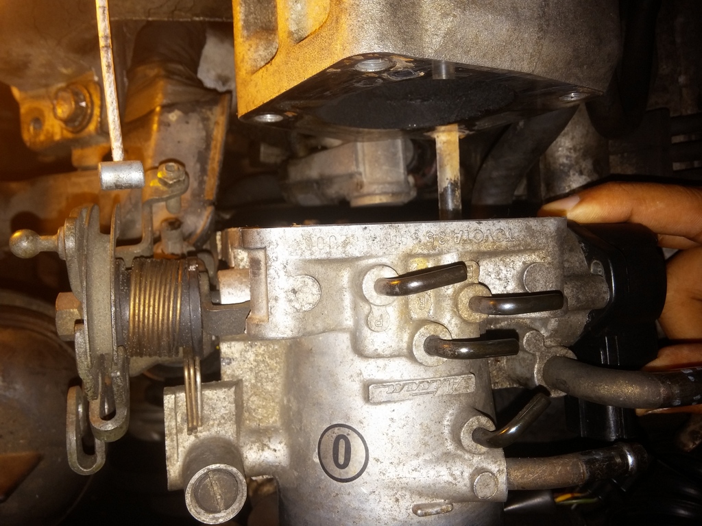

in the second photo this where my tps sits at idle but the holes to secure it it aren't lining up. i should also mention that the throttle plate is in contact with the stop screw

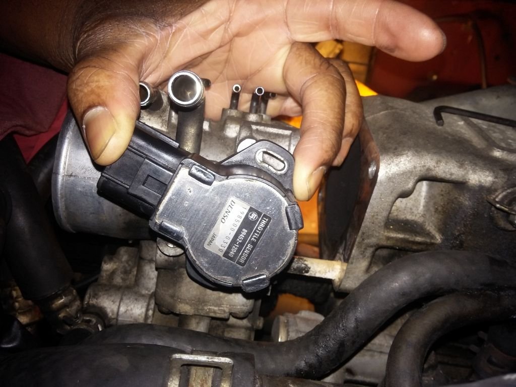

now in the third picture the tps is mounted in its lowest position to line up with the holes. As a result the throttle flap opens a considerable amount. ive tried adjusting from this point but to no avail. the engine constantly surges into the what sounds like 3k rpms if i were to put everything back together and start. the tps is good and is an OEM part from toyota PN #98500-0330
now guys my question to you is am i supposed to follow the procedure to adjust the tps while it is in this known position? ive tried to adjust the stop screw a few times and mounting the tps in numerous positions but i always end back in the same positioning for the idle. any help would be appreciated in clarifying where i should start.. its such a stupid issue i hate asking but ill be the idiot for the day as long as i can get my truck back on the road. thanks guys

Ok sorry about that. I removed it because it had an idle of about 300 rpms and a misfire. I performed 2 complete tuneups. After running on the highway for an extended period of time, the truck would stall out at intersections. So when I went to adjust the throttle position sensor by loosening the 2 screws... the sensor fell off the throttle body. I'm assuming it was never properly on the throttle body ears in the first place..

ok i see. based on the picture you posted, it doesnt look like my throttle body since the sensor is on the opposite side. i had some trouble tracking down the FSM since most of the links i had tried from other members and sites were expired. ill try to find a copy go off that but i understand what you mean. thanks for the input brother

this is my problem, i understand when i put it on there should be some tension BUT with the throttle position sensor i currently have, it is literally impossible for the throttle butterfly to be closed to the point where i can start adjusting...now this leads me to believe the sensor i currently have is incorrect. my readings with my multimeter never read infinity so i dont have an area to begin the adjustment. is there anyway someone can give me the part numbers for this engine?

Perhaps the paddles connected to the butterfly valve shaft are wrong for your TPS. They can be 90deg shifted depending on the model year. Check it out:
It is indeed possible that your TPS needs the other paddle to properly align itself. That pic I took during my early to late model intake swap. The link to that mod is in my signature where there is a bit more description.
Maybe if you took a pic of the paddles (with TPS off and butterfly valve closed/at rest) it would help pinpoint that for you. Sounds to me like you need the different paddle.
this makes soooo much more sense now, thank you!! ill go pull it apart and see what i find.

OP, you're only about 30* off from level, not 90*, and I highly doubt someone swapped ears into your TPS anyway. That part is for the 22re engine. The 3vze TPS came 180* apart year-dependent but the procedure for adjusting them is the same, hence that different pic above. (Jenny do you have the 4 or 6 cyl?) I would agree with the guy above me that you probably have the ears slightly out of position. The TPS is incredibly sensitive to set, a hair either way can throw it out of adjustment, you'll need an ohmmeter.

yea after cross checking. it seems the ears are correct for the throttle body. yea i checked all that previously. i purchased a new tps out of haste about a year and a half ago after my ECU took a ˟˟˟˟. so before i changed the ECU i basically threw parts at it for about a month. i bought a new tps (the one in the above pictures) and had my friend throw it on for me since i was out of town at the time. it wasnt until i changed the ECU and got the truck running again that i was able to notice the idle issues... the truck ran decent for that time. it wasnt until recently that it started to stall. so i pulled it off to adjust and here we are...
