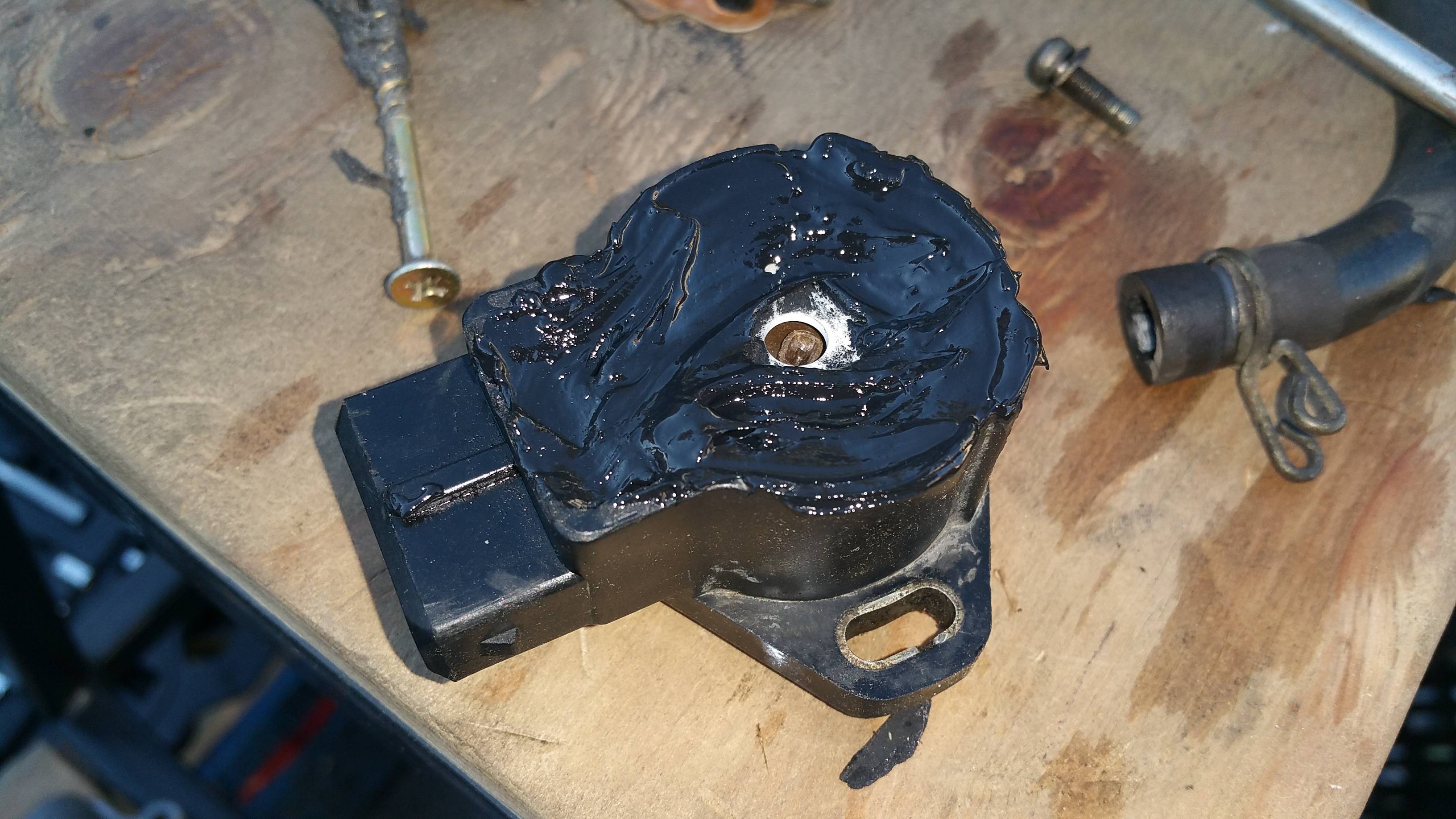

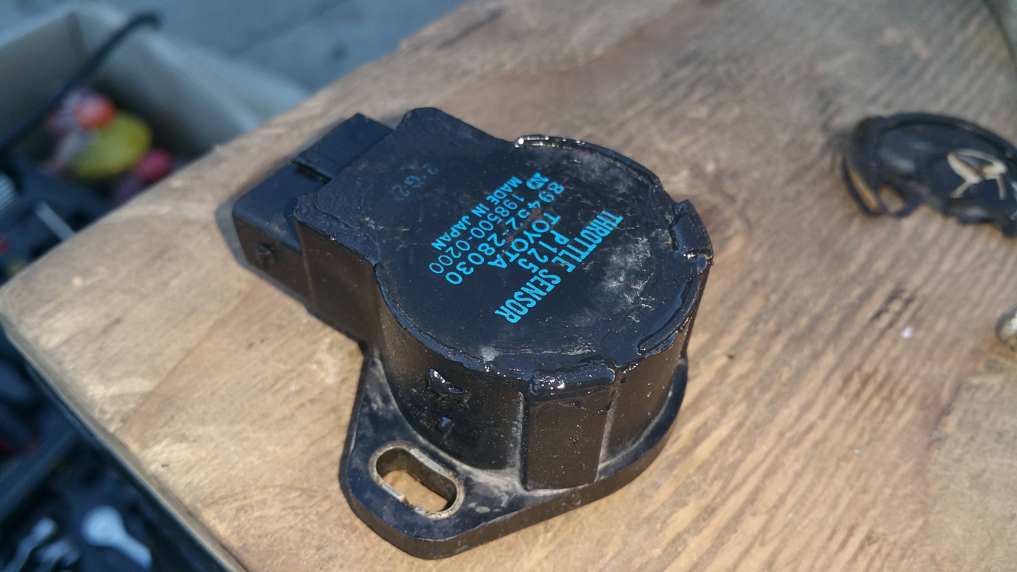

My TPS was binding up a bit, and after lubing it (per the suggestion of a friend) the electrical contacts seemed to be acting erratically.
Rather than toss it in the trash as they then suggested, I decided to say what the heck and crack the sucker open to see what could be done.
As you can see there was a good deal of crud around the tracks. I blasted it with some electric cleaner, put the teensiest dots of dielectric grease on the 4 terminal like things and sealed it back together with some silicone sealant.
Tested perfectly during calibration, and now my car runs better than before

I would recommend putting a piece of electrical tape over the back of the internal contacts before resealing. I just realized I may have gotten lucky.

Just out of curiosity, that's not the vinegary silicone sealant correct? If so, vinegar emits acetic acid and will corrode those contacts. They say not to use vinegar smelling silicone with electronics since it will corrode contacts and electronic components.
Old Nov 19, 2014 | 10:10 PM
jennygirl's Avatar
Joined: Sep 2014
Posts: 507
Likes: 8
From: LA CA
It was a black marine silicone (all that I could find in the garage).
If it starts acting weird or if I get a CEL, I'll post it. Just went on a short errand with some friends and everything seemed great so far! The real kicker will be engine heat over time, I think. Prolly will use RTV if I have to do it again.

Small update, I noticed my sealant cracked after 5 months (probably due to temperature changes and vibration is my guess). I will use a better sealant next time.. Probably the black gasket maker stuff from toyota. I'm also open to suggestion
I refuse to buy another TPS!!
