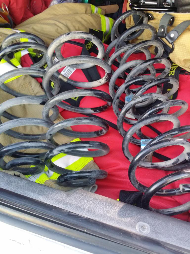

I had been considering doing the zuk mod since my yota is a victim of the rear sag from the flattened leaf springs. I was talking it over to a buddy of mine from work when he mentions that he had set of jeep factory springs laying around and he'll give them to me for free! After about 2 weeks of finally being able to arrange a time to go get them, I got them and are in the bed of the 4runner. Name:  2014-05-31071058_zps6b3c0739.jpg

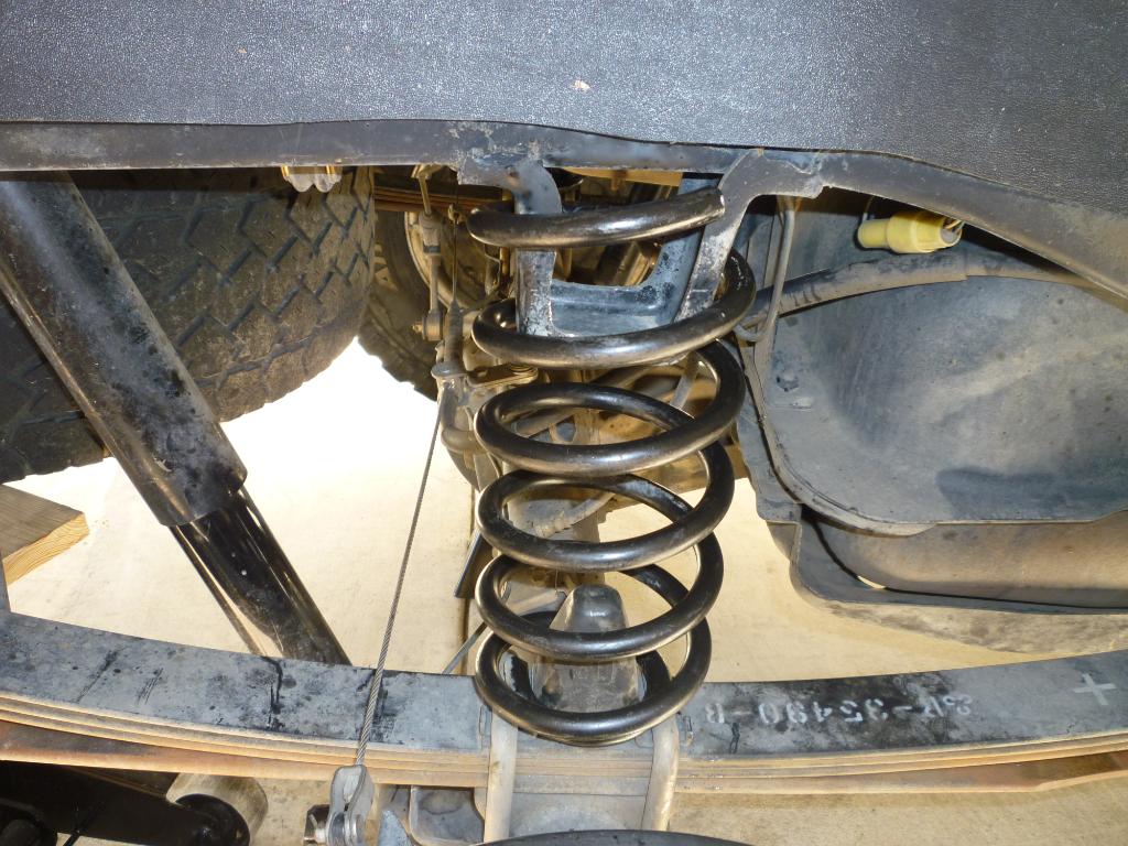

I have jeep cherokee front coil springs on my 4runner, i think they 18'' long and cut them down to 14'', i still didn't like the rake on the rear, so, i cut them to 12'' and that was perfect for me. Name:  P1060916.jpg

From: El Paso, TX
oh ok, that's something I wasn't sure of... the rears are 14" and the fronts are 18" from the ones I got. I was gonna use the rears since they are wider on one end. Should I go with the fronts instead?
Old May 31, 2014 | 04:53 PM
maco35's Avatar
Joined: Feb 2010
Posts: 504
From: L.A. CA.
I'd use the rears since they are already 14'', if you don't like the way it looks you can cut them down to 12'', or if you like the rear to look really tall then use the fronts. You have plenty of material to choose from and play with.

1. 1988 4runner DLX 22re 5-speed
2. 2010 Jeep wrangler rubicon both front and rear springs p/n's fronts 6800 4458AA, rears 5212 6317AC

thanks for your input, i'm gonna go with the fronts and cut them down to 13" instead of 12. I do want to the ride to be soft and these springs, from what I've researched, are soft and not too stiff. I'm gonna start today, i'll post up my before and afters...
