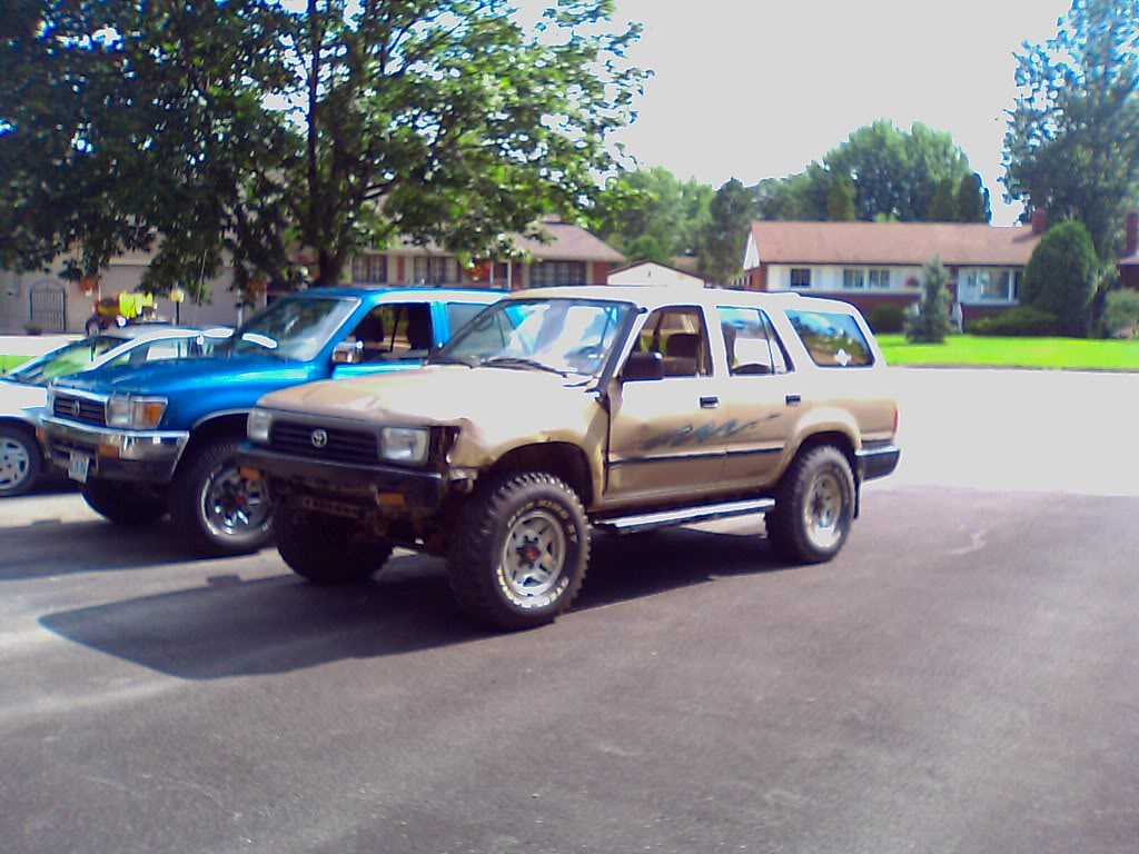

help me find a gas leak!!!
its coming passenger tire side of the frame
cant see any leaks!!
fix a portion of lines with rubber hose and they work fine... tried looking while truck was running and couldnt find it either
heres a pic
please help me!!
im about 1200 dollar in parts in my ifs trail rig and just want to have some fun!!
