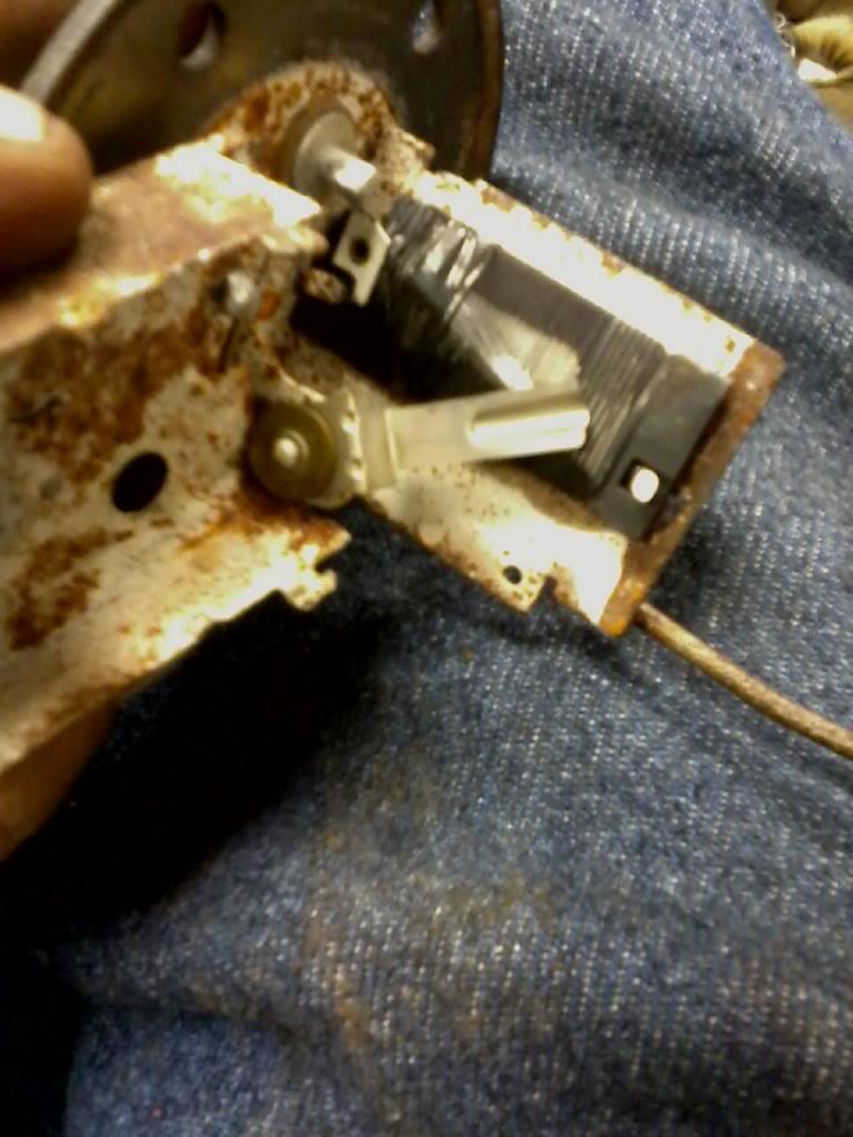

mine did a similar thing. mine would work fine till a quarter tank then hold there for a while. then drop to e for like 10 seconds and then go back to a quarter and stays there to you run out of gas on the road if you dont notice the drop. I replaced the sending unit and it appears to fix the issue.
Old Jul 24, 2014 | 01:56 AM
  #38
Terrys87's Avatar
Posts: 11,787
Likes: 28
From: Anderson Missouri
What happens is the wiper on the float assembly eventually rubs the wire which is fine as a human hair until it breaks the wiring. Everytime I have seen it happen, it is always at the bottom of the float which makes sense as it is the part that will get the most rubbing.
May not be able to see it to well but here is an example.
