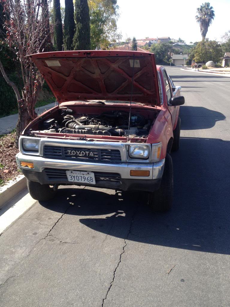

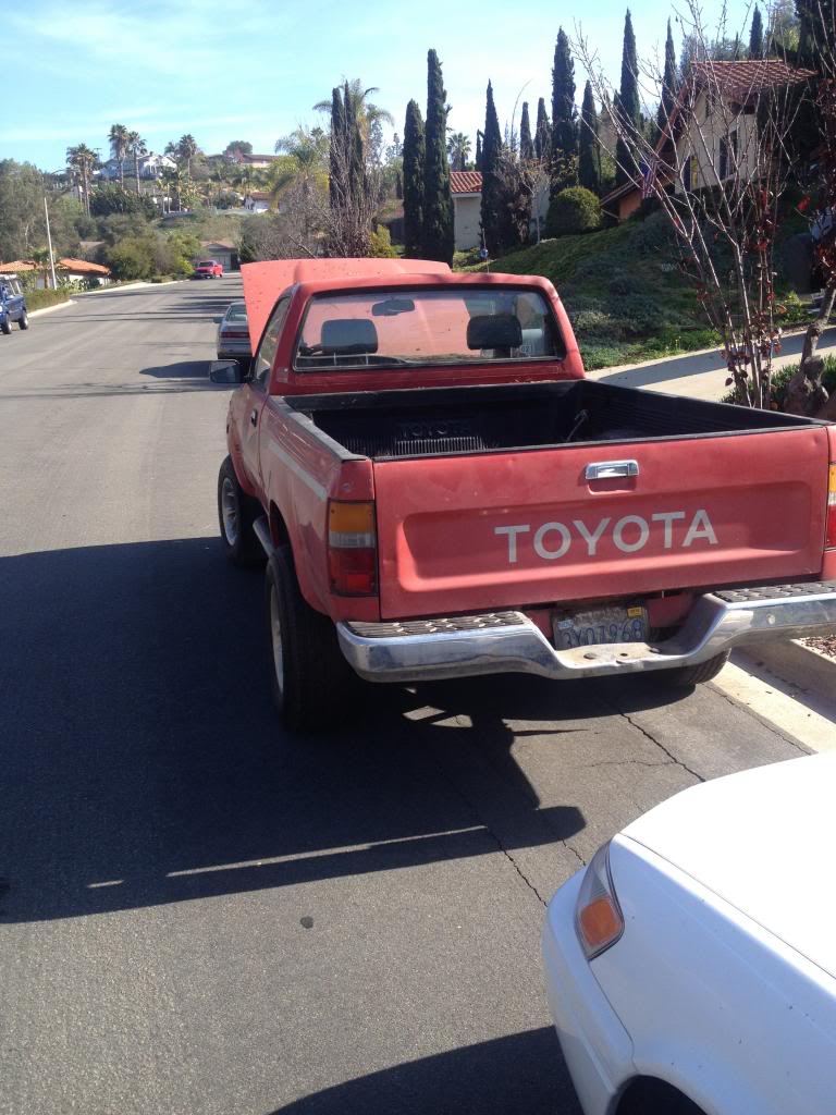

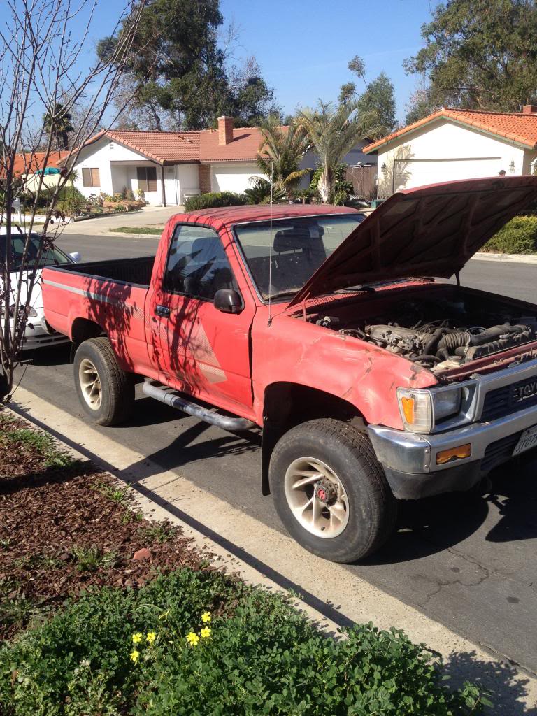

wanted to post some photos, finally got it to the house. Looks like it might have tipped on its side, overall in good shape though. engine bay looks good. IT EVEN HAS THORLEY HEADERS!
fired right up! I can't believe it.
From the way it sounds and from research on here I think its probably one of those situations where the timing chain is fudging with stuff and causing the oil and water to mix.

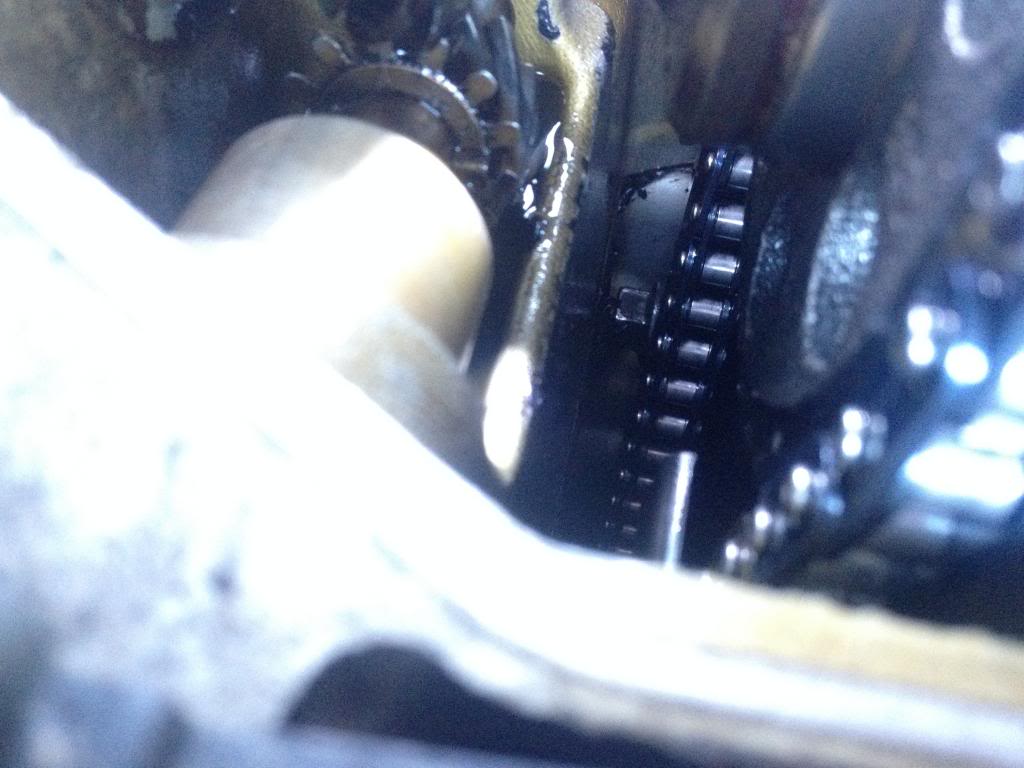

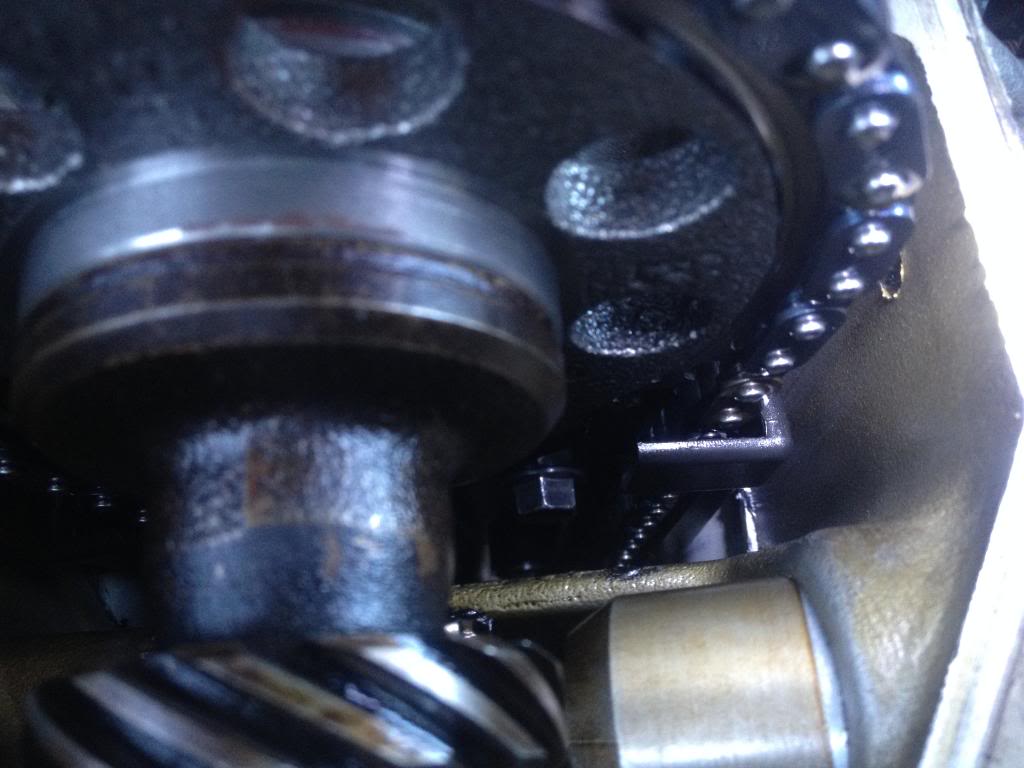

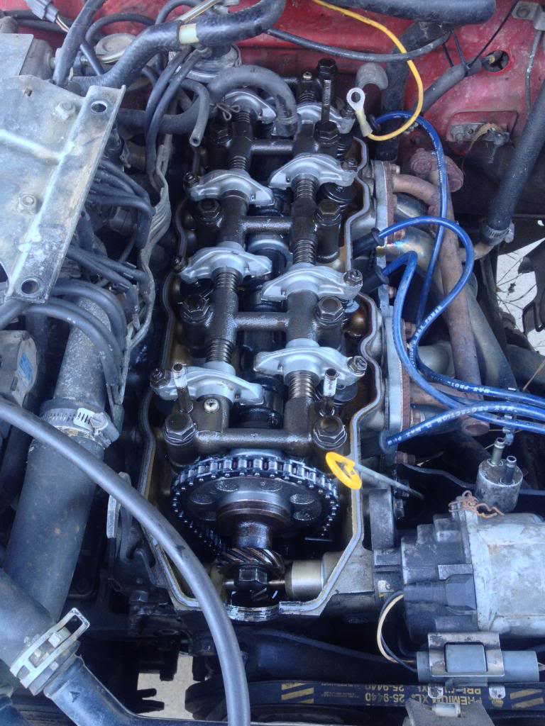

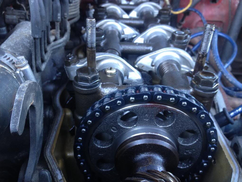

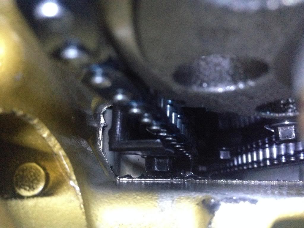

little update. did a compression test, number 1 is down. as you can see from the pictures the timing chain looks new, I can look down inside and it looks like the guides are newer (and plastic). Is this how they are supposed to look?
I pressure tested it and didn't see any antifreeze like I've seen in some posts..
there does seem to be residue suggesting the head gasket is blown, but I was really hoping it was just the timing guides... look at the pictures and let me know what you all think.
how much play should I be able to get out of the chain? like if the tensioner down lower where I can't see is messed up...

I'm gonna say you've got a 92 or 93. Somebody has been in that motor for the head to be that clean. I didn't read all the posts on the page only a couple. If the head gasket is shot and you do have milk sitting in the oil pan and it's been sitting awhile. I would almost assure your gonna need to rebuild the whole motor. Nothing will eat up crank bearings faster then anifreeze.
Do you remember what the compression numbers were on 1,2,3,4?
Your timing chain looks perfectly fine, the chain tensioner is way down on your left side. If you take a flash light and follow the chain down inside the timing chain cover you'll be able to see a small shiny shaft coming out of the tensioner body. It's bolted directly to the front of the block. I love these old 22re and 22r. I ve fully rebuilt 1 22re in a 95 that I use to have that I put 70,000 miles on before selling and have had to do a couple head gaskets here and their on different ones.
Where are you at now with it?
From the pictures of the head it doesn't look like the oil and water mixed. Usually the tops of the head bolts will be white and the oil in the head would be milky.
Are you sure the head gasket isn't leaking directly into the cylinder?
so here is the update. Someone did a timing chain kit on this... and did a TERRIBLE job. pretty sucky. Lots of missing parts. So i'm re-doing everything. cal was 60, 2,3,4 were all 160 or something like that.
finally got the front cover off to see that the aluminum fin that is closest to the bottom sproket is completely gone... time to pull the oil pan and find the pieces...
