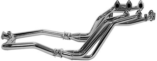

I did the same thing over the last year that you are doing now. I used the LCE headers on mine. They're ceramic coated and look like they will last pretty well. I did have some fitment issues on the y-pipe, but they worked through it with me and made it right. I ordered tons of parts from the overstock toyota online site and the toyota parts deal site, and from Rockauto, and from Amazon, and from the local dealer, and used parts from car-part.com. Good luck with it! Don't forget to check and grease the hubs if it has been sitting for a few years.

thanks for the info..I'll definitely check out those headers..what type of fitment issue were you having..my current exhaust system consists of the NWOR full length headers connected to their y pipe via a socket and 2 bolt flange set up then going into an aftermarket high flo cat (also purchased from NWOR) then that dumps into a stainless borla cat back system
found a pic of the NWOR headers and y pipe set up
