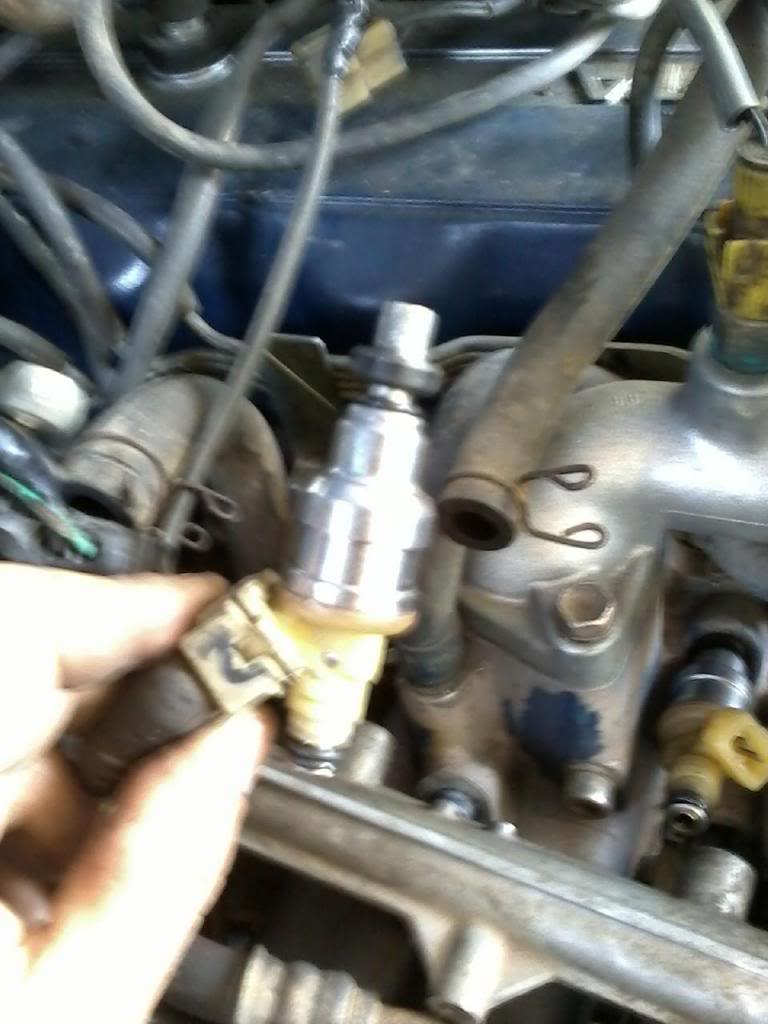

9. 85-87 Injector connectors are a poorer design then the 88 and up. The early connectors use a C wire clip that is the same as the Cold Start Injector wire clip. I use a finishing nail to remove the wire clip. Also the early injector connectors can be brittle on the 85-87 so use care as it is possible for the little skirts on the connectors to chip and break. The 88 and up connectors have a little squeeze tab.
10. On all 22re years, I suggest using a magic marker and number your injector connections. It is possible to get numbers 3 and 4 backwards if not careful. Here is a picture of some of the hoses I disconnected and talking about as far as connectors>>> https://www.yotatech.com/forums/f199...l#post52100494
