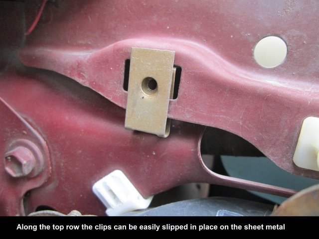

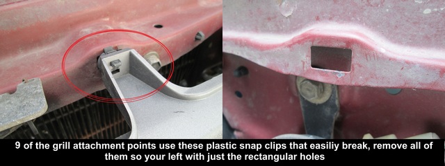

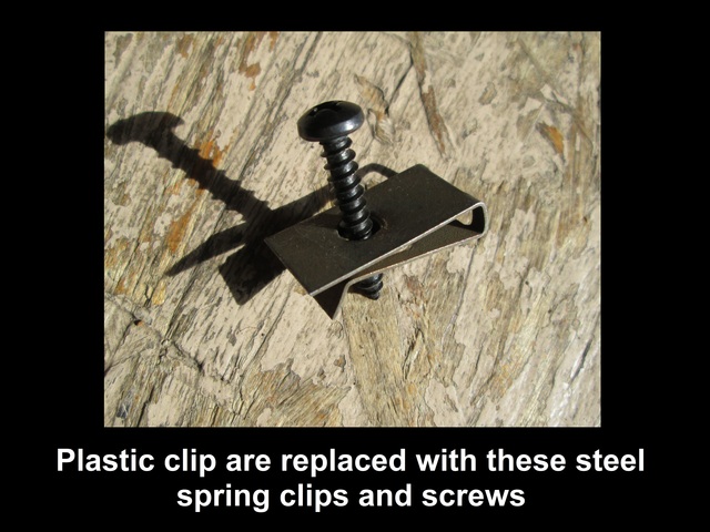

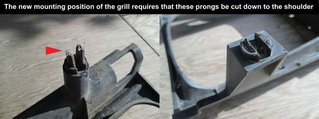

This is an easy way to fix the attachment method used to secure the grill, mine is held in
place by 2 screws and 9 plastic clips, all of which have broken and have left the grill flopping
around, I decided to get rid of all the plastic clips and replace them with screw clips.

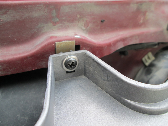

Common Phillips screws fit through the holes in the grill without needing to drill them larger
and hold the grill securely in place
