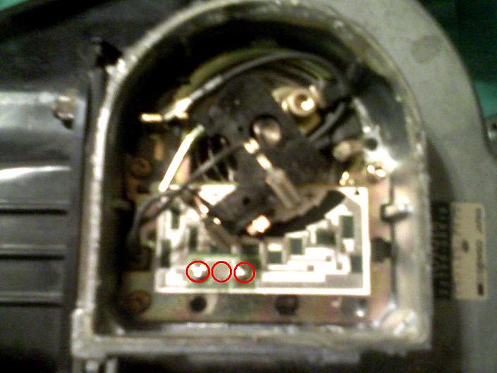

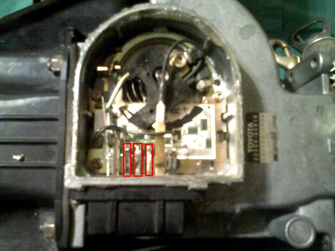

I opened the plastic cover from the top of the Vafm and saw that I had ripped the three main terminals from the electronics inside. These three terminals had been torn off when I attempted to remove the base of the connector instead of just unplugging the wires on the harness.

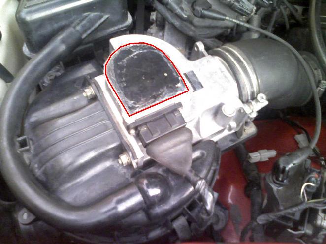

I have soldered many electronics in my day so I simply soldered the corresponding connectors back onto their corresponding terminal end on the board. These three are the only ones that touch the board so the rest of them I simply reconnected from the inside before closing it up again.

**I'm no electronics expert so what worked for me may not work for someone else, but Ill post some pictures of what it was like inside the Meter.**
Picture 1- The VAFM Lid removal
Picture 2- The three terminals that the prongs needed to be soldered to
Picture 3- The prongs firmly soldered to with the rest of the terminals plugged in.
