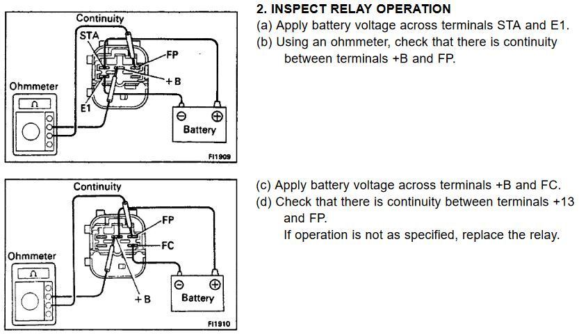

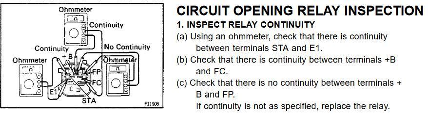

I took the relay out (which by the way is a pain in the ass!) and checked the continuity and operation.
It seems I have no continuity between +B and FC... Guess I have to try to find a new relay?
When I checked the power operation, both options worked..
Can someone verify if the non-continuity between +B and FC can cause my problems?

There are 2 coils inside the COR relay, one of them is energized at cranking time (I'm betting the STA to E1), and then the other is energized by the AFM Vane (this I'm guessing is the +B to FC), so if you don't have continuity between +B and FC terminals of your COR relay, then that coil is burned out. Which looks to me like your fuel pump will get no power once you stop cranking engine. But then you go on to say that when you applied power to each of the COR coils, both cases showed continuity between +B and FP, which does not make sense to me. If the one coil is burned out, then you would think that one of the 2 powered tests would fail.

1A - Continuity
1B - No continuity
1C - No continuity
2A/B - Continuity
2C/D - Continuity
I have tried jumping the fuel pump by using the diagnostic connector (FP to B+). This makes no difference, it still only runs for a few seconds.
