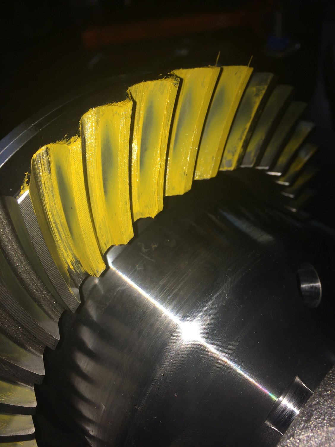

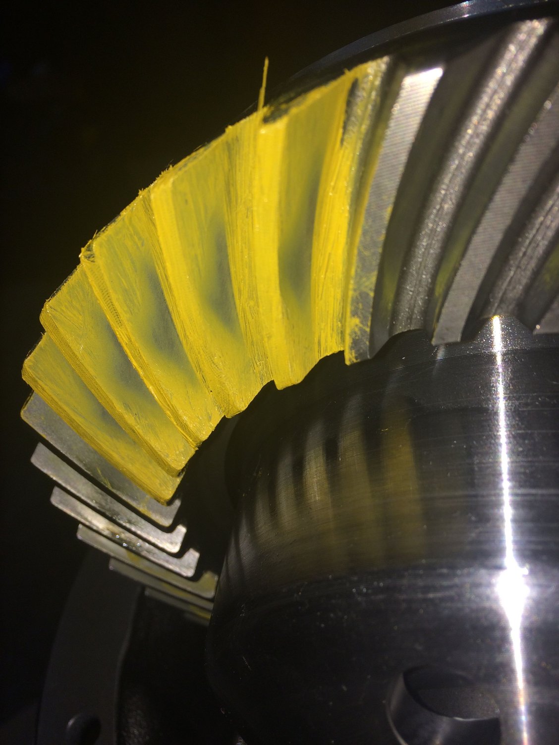

So I ended up getting a new housing from Marlin Crawler and after some distractions I'm back on track. I've got some gear patterns and thought I'd try and get some input. The first picture is with a .08" shim stack and I thought it looked like the pinion was too shallow. I went to a .0865" shim stack and I think it still looks a bit shallow but I'm not 100%. The last three pics show this setup, any thoughts?

Old Mar 21, 2018 | 05:09 AM
coryc85's Avatar
Joined: May 2005
Posts: 1,979
Likes: 233
From: S. FL
That drive side looks bit shallow to me. Here is my gear pattern https://www.yotatech.com/forums/f199...l#post52074409
You said you are adding shims, but when you are too shallow like that, you need to remove shims to push the pinion deeper up into the ring gear. Did you set your backlash as well?
EDIT: I said remove shims, but I'm not thinking too good. I think you are right, add shims to space the pinion head up. I ended up using about .074 shim stack, backlash set to .008.
And as Co_94 said, www.gearinstalls.com has TONS of pictures. And BTW, good job, gear installs are tough, lots and lots of little steps.

Went to a .091" shim stack and I think it looks pretty good. Looks a little closer to the flank side than the face but I read on gearinstalls.com that this is desirable. I know there's plenty of reference pics out there but since this is my first setup somebody confirming my work would make me feel more confident, and potentially save me from a costly mistake.
The .0865 patterns are the best you're gonna see with that gear set.The depth is perfect.
Ken (ZUK)
Old Mar 29, 2018 | 08:37 AM
ianD's Avatar
Joined: Mar 2016
Posts: 42
I had got some positive feedback from other sources on the .091" setup so I went ahead with the final assembly. Considering your reputation I'll take your word for it. I haven't installed the 3rd member yet so redoing it isn't out of the question but I'd rather not unless absolutely necessary. Is the .091" setup gonna give me problems down the road or is it close enough, just not "perfect".
