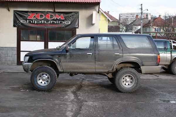

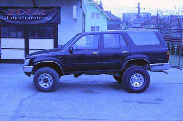

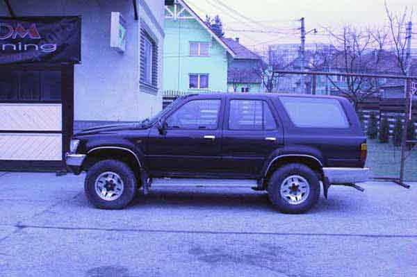

Finally i have finished lifting my 4Runner.
I used the OME suspension kit + OME torsion bars with 1.5" Sdori BJ spacers and coil spacers from strap22 (Thank you Phil).
After i mounted the OME kit, i need to crank the torsion bars to have clearance for the 33" tires , but the ride was to stiff, and also the CV angle was to high.
So i ordered an 1" BL , and differential drop kit from 4Crawler (thanks Roger).
After i mounted the BL, i lowered 1" from torsion bars, now everything is fine.
Some pictures before and after : (the quality of the first 2 is not to good...i forget to adjust the white balance)
Before :
Back lifted :
After:

Haha.. How long did you drive with just the back lifted? I assume a while judging on how dirty the rear tires are in the last pic
That is a great looking truck man!
I drive the car about 1 week without the BL.
I took the picture after we finished.
Zoli
