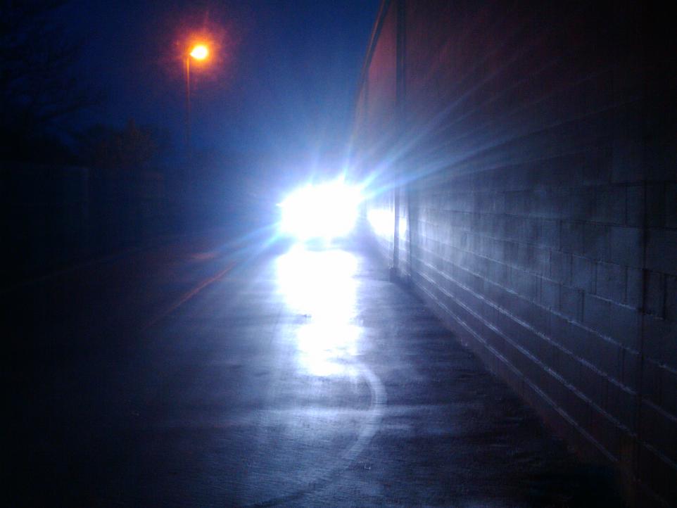

thats my truck with 6k there plenty bright

that picture i posted up are those ddm tunning hids 6k with 35watt ballasts. i bought them after i seen ur hella 500 conversion to hids lol there amazing
