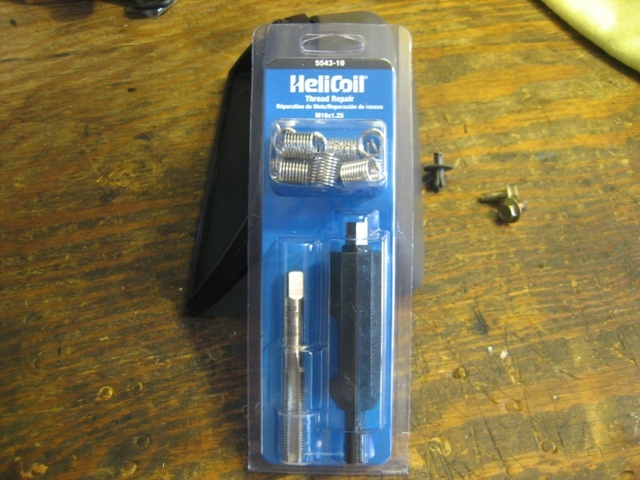

Did this not too long ago. This is a picture of my kit.
Looks like the label says 5543-10 which would make it the Helicoil 5543-10 M10 x 1.25 Metric Fine Thread Repair Kit
Helicoil 5543-10 M10 x 1.25 Metric Fine Thread Repair Kit - Amazon.com Helicoil 5543-10 M10 x 1.25 Metric Fine Thread Repair Kit - Amazon.com
