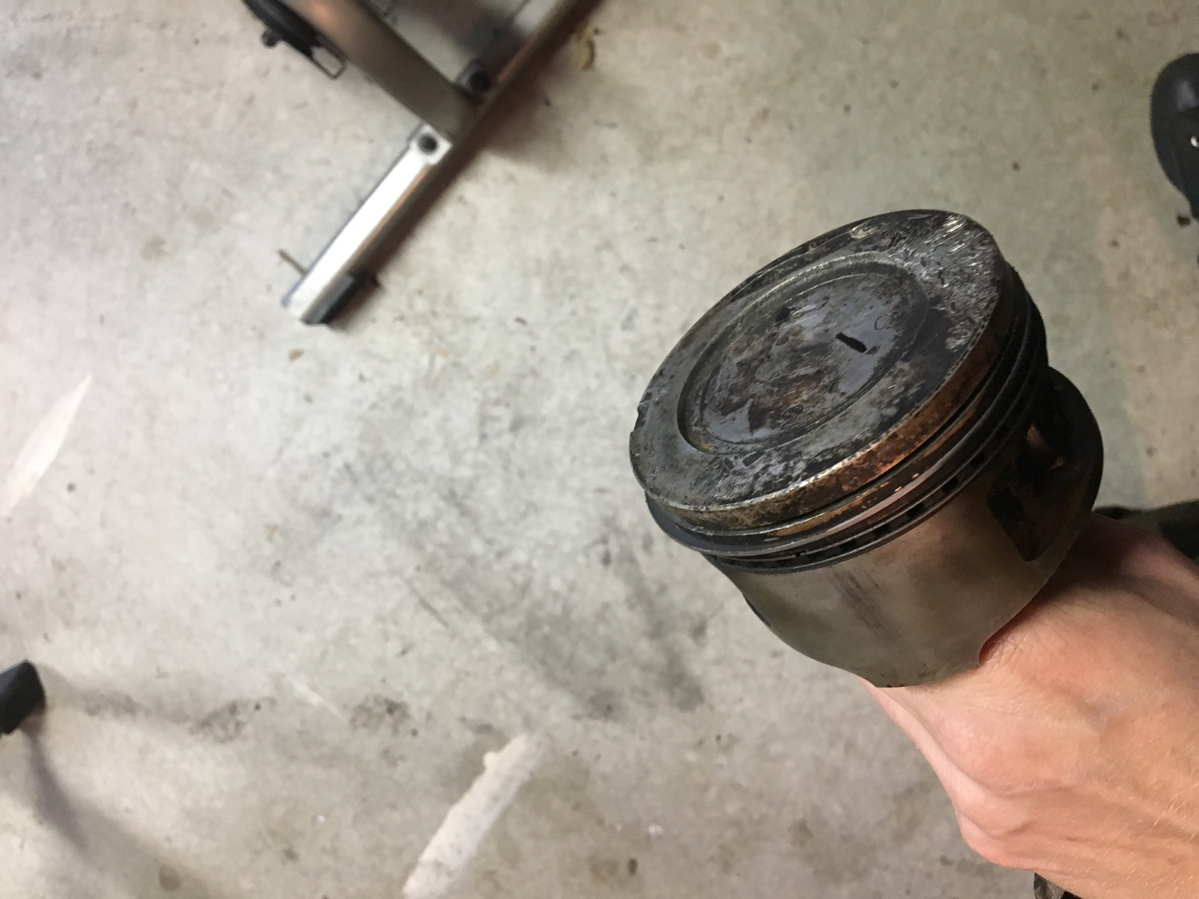

So I found a guy on Craigslist letting go of a 22R/E block/head (Late model) for nothing. He essentially fried it, saying the cold start injector leaked into holes 1/4 and stripped the oil off of them, killing the engine, and he didn't own a 22RE powered car anymore.
Now while I'd be hard pressed to call the man a liar, but I don't think that's whats happened at all, the block is in great shape, so is the crank/rods, and pistons. (The pistons have superficial damage, nothing on the crown)
To me it looks like somebody dropped something into one of the intake runners and the engine ate it to pieces.
It however does need a cylinder head as it was Shot-peened by metal fragments, needs rod bearings and possibly crank bearings, the block may be runnable but may need a hone at the very least. The pistons are scratched but very minutely, with no damage to the crown.

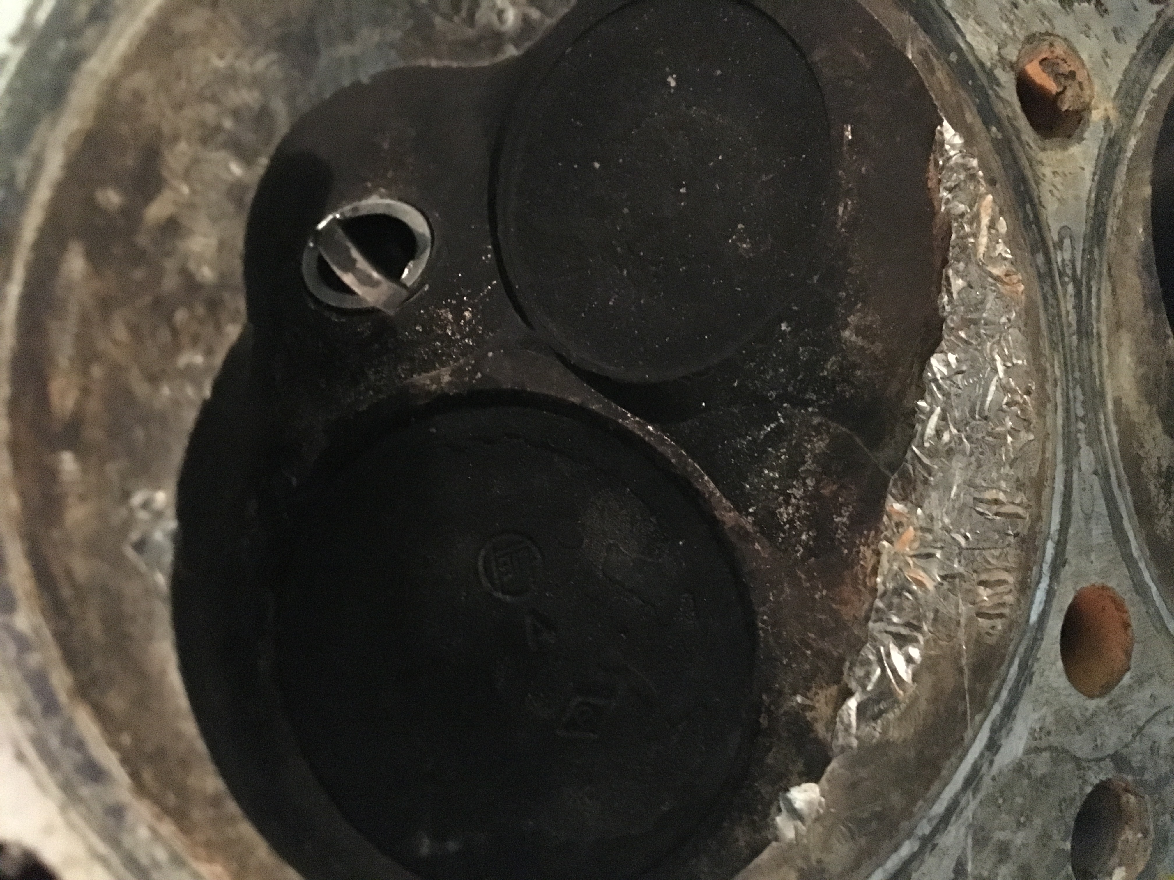

This doesn't advance your inquiry, but I can't help but notice that PART of the top of the piston and PART of the head look like they've been hammered on. What could come loose inside a cylinder that would do that much damage in the quench-space, but not even knock the carbon off the valves? If I had to guess (which is all I can do), I might think that a large piece got into the cylinder, but the engine never RAN after that. Instead, it was cranked a few times (very low RPMs) and that vise-gripped the intruding piece between the piston and the head. But it never ran fast enough to actually knock the piece around.

My best guess is somebody dropped a washer or something very small in one of the intake runners, drove it briefly, sounded weird, and there it sat until l I got it apart. My bet is washer or one of the threaded adapters for certain spark plug wires that thread onto the back of old- school plugs.
Also on cylinder 4 it did knock off some carbon, and there are actually marks on the valves themselves.
Weird that it'd be both 1-4, which is why I guess he determined a leaking cold-start injector.

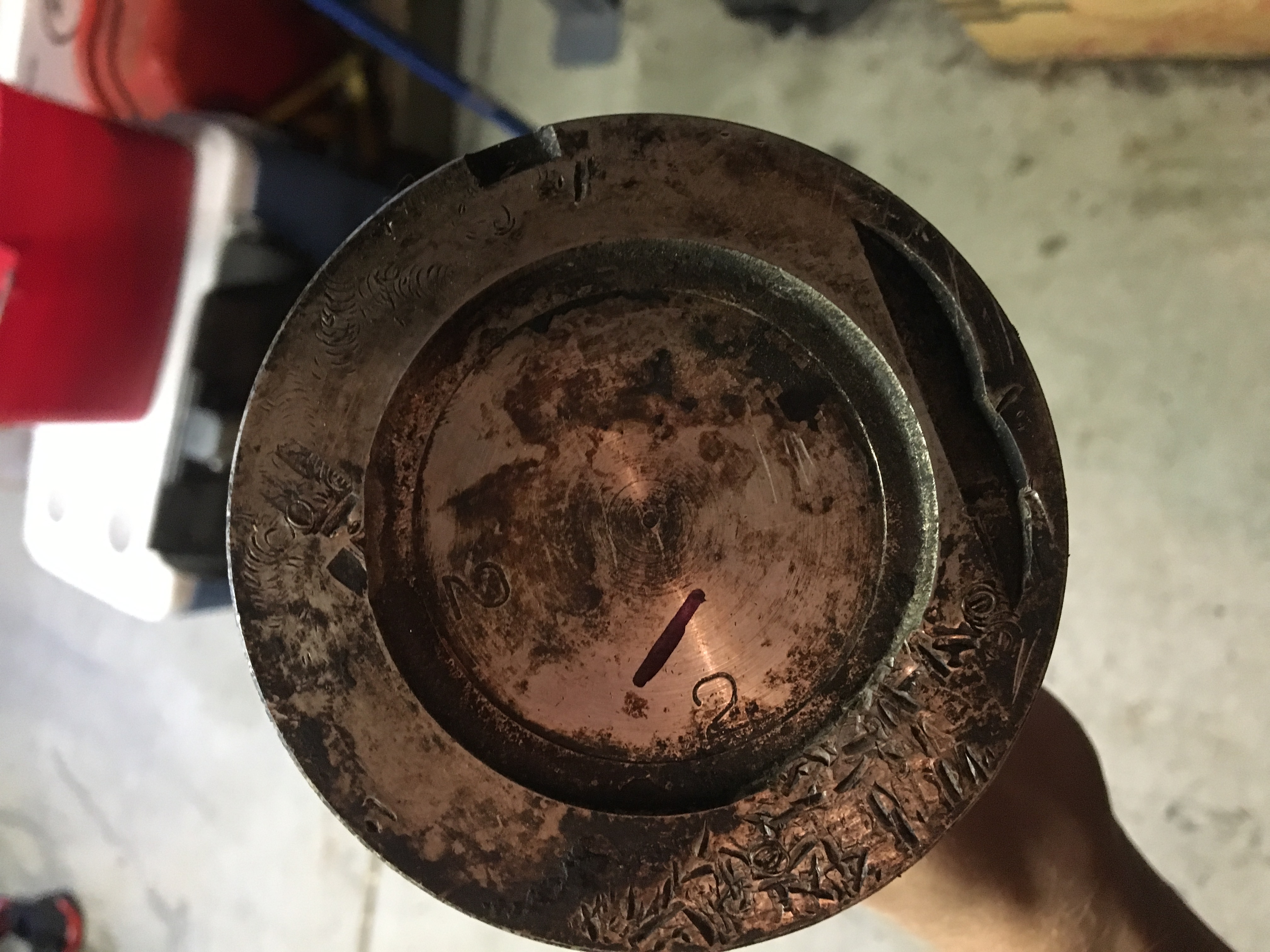

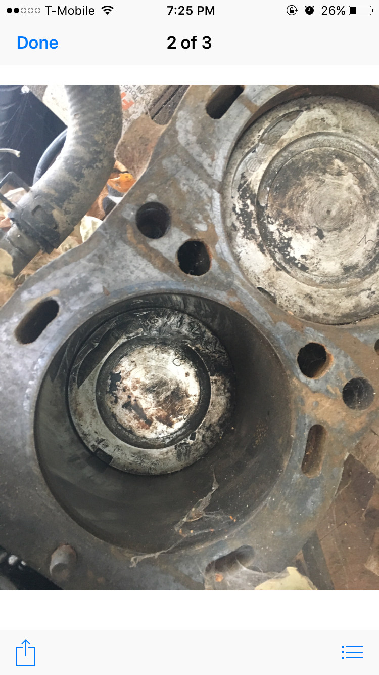

#1 lost the upper ring, that cylinder is very gnarly.
You are going to need to measure it up and see if you can get it bored and trued up and stay with in the available part sizes.
Once you start boreing out the cylinders you will lose compression ratio. So if you want more power your only real option then is a stroker kit..
