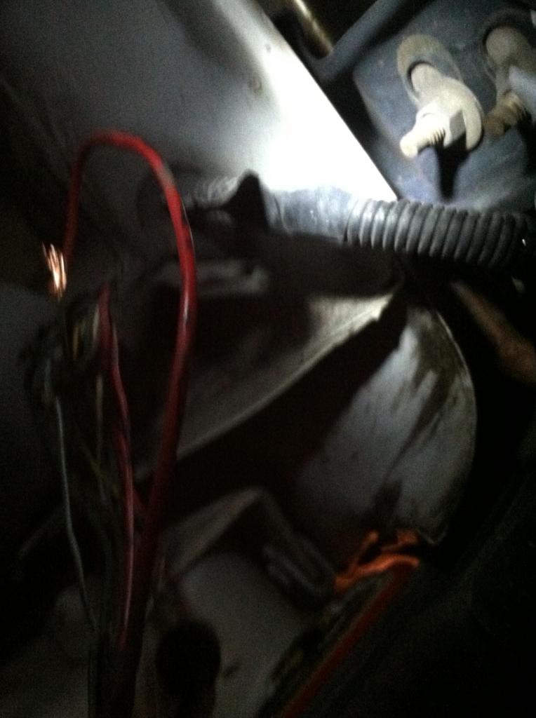

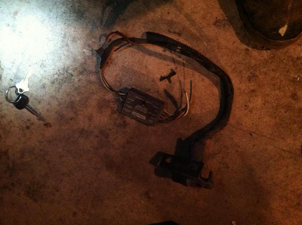

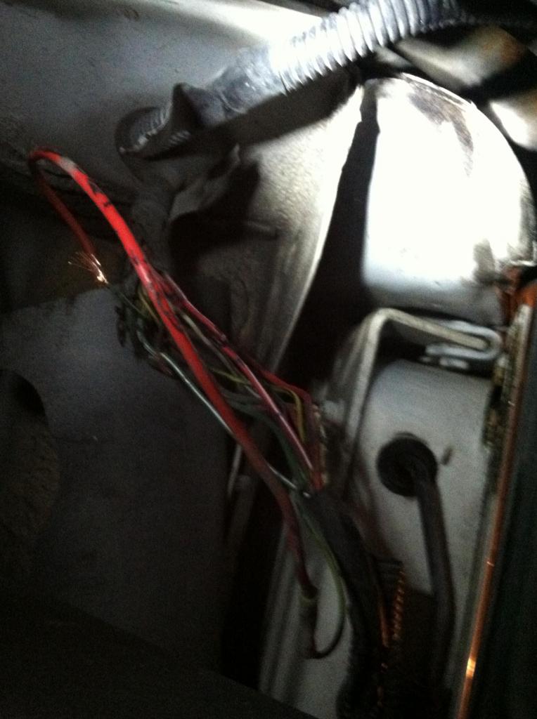

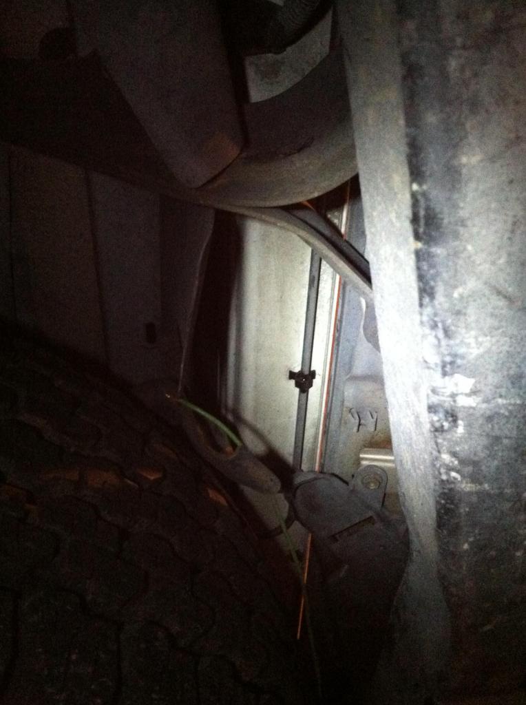

I had some horrible looking trailer wiring, which undoubtedly is the culprit here. Wires were frayed, exposed, broken, etc. I cut it out and repaired the damage that I could see. Couple of things though.....there is a fairly thick (12-14 gauge) green wire coming from the right rear side of the truck, which goes into the truck through a grommet. It was exposed and not connected to anything, but I could see that it was part of this trailer wiring mess. Where does this go? What should I do with it?
Also, I cut out the trailer wiring switch board, if you want to call it that, and now there are 4 wires just sitting there that seem to go up into the left side of the car, also through a grommet into what seems like the door control unit area. I was thinking that this trailer wiring was added, and thus would just be able to be unplugged or cut out but it seems more hard-wired than that and less plug and play.
So now that there is a backstory, I am looking to completely remove all remnants of any trailer wiring setup and determine why there is no juice to the fuse panel by my feet. I am assuming something elsewhere is blown preventing power to this area but I don't know where to look.

Your no system voltage to the inside fuse block could be a fusible link.
Although hard to say without knowing the year

About a month after installing a stereo I had those same symptoms. Dash and taillights out. Stereo worked fine. After searching threads and seeing my trailer wiring I pulled it all out and capped any exposed wires. I was still blowing that fuse. I undid the new stereo and grounded both vehicle side ground and stereos ground wire to bare metal on the chassis. No more blown fuses for over two years now. I got new trailer wiring but haven't put it back. Someone will mention if I were smart enough to use a meter I could have found the problem sooner. Anyway, you might have a ground loose somewhere.

I loose or removed ground seems plausible considering there are now 5 exposed wires; the four that were going into the trailer wiring circuit board thing and this fifth green wire coming from the back right side of the car.
The next thing I will try is grounding out each wire and seeing if that does anything.

Grounding the wrong wire is how u blow fuses- LOL! Wanna do this right? Fellow members help others based on stock wiring, so I highly recommend u find a schematic, get a multimeter and restore to stock cleanly. Inspect (look, feel,smell), and test each and every wire and connections a u do it.

I took the truck to Toyota thinking they could at least spend time finding the problem. They told me it was the "integration relay" which I purchased on ebay. I installed this piece tonight in addition to a new tail light relay and it still doesn't work. Because I noticed that one of the fuses was burned into place a few weeks ago, I wonder if it is the whole taillight relay block. I may take this to a mechanic because Toyota wanted $1200, which I obviously couldn't do. I hate gremlins
