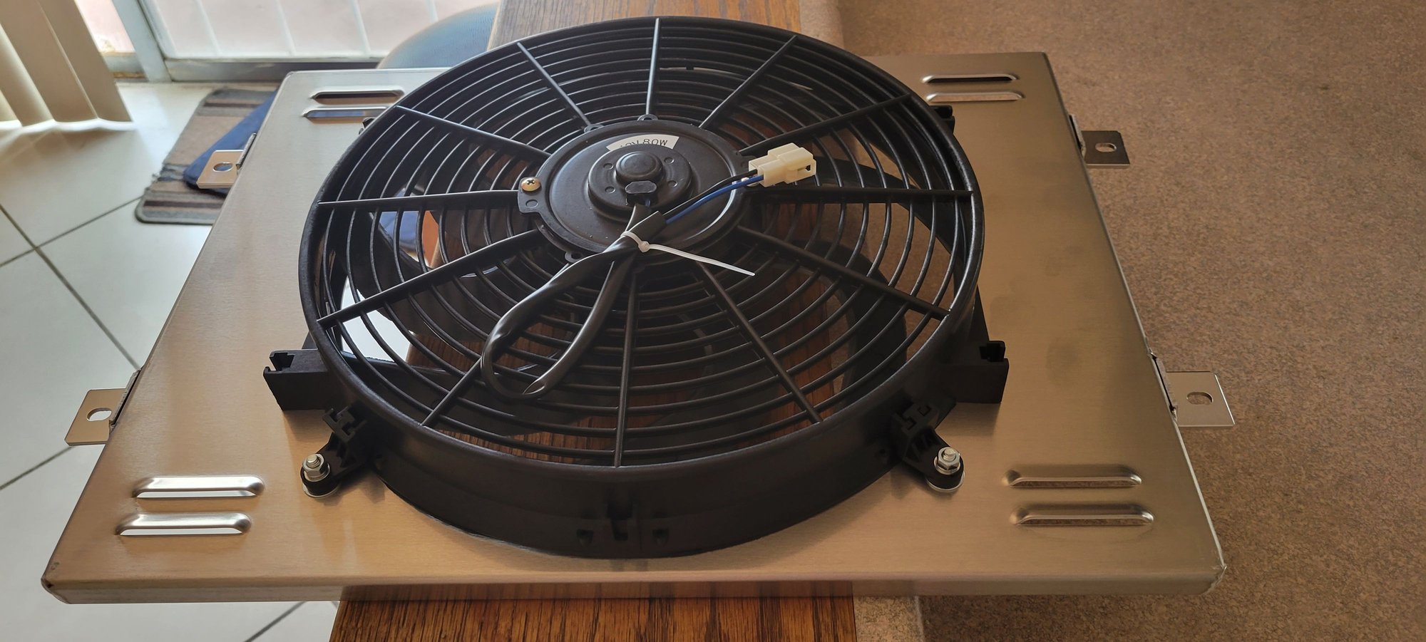

E fan help wire in on from key.
Just did E fan swap on 22R (1986) with A/C with a Ebay fan with a Aluminum Shroud that bolts right on Radiator 4 points seems to be good but just want to wire it correct, only care if turns on when key is on nothing more so on full when running. In AZ so ok to run all time tested on battery not to loud so fine if turn on key and on all time.
What is the best place to tie into a switched power and where power and how or what relay to I guess run main to battery to make this work? Should be simply but I can't find a switched line in engine bay and really don't know how to wire a relay from scratch so help on that would be great also. If can post with pic of here is the spot to tie into or this wire be great wire diagrams can't follow.
Any help thanks. Just a 2 wire fan.

I lived in Yuma for almost 30 years. I bought my 87 Hilux pickup in 88, and I bought a 87 4Runner in 95. The only mods I did to the cooling system was a 3 core, all metal radiator for them both. I used the 190° 2 stage thermostat. I never had a bit of trouble with the heat, and you know as well as I that Yuma gets some heat. As long as I kept a functional OEM fan clutch in them, the fan did fine. Matter of fact, the Hilux still has the same radiator I put in it back in 89, and it still works good.
Point being, for what my opinion is worth, go with a good CSF all metal 3 core radiator, and an OEM fan clutch, and you'll be in good shape. Every electric fan installation I've heard of has been reverted to the original fan clutch and fan eventually.
Again, this is just my opinion. I would think you'd want an "always hot" to run the fan off. Let the fan's thermostat operate it as needed. Does the fan's installation instructions specify keyed power, or an always hot off the battery? I would think that the fan's manufacturer would know best how to hook it up.
Not a lot of help, but it's what I experienced with my Toyotas. If you insist on installing the electric fan, on keyed power, I'll see what I can figure out for you to hook up to.

I'll see what I can figure out for you to hook up to. -all in now so please do cause it's installed and no going back to just key easy turns on key and all good (and not fuse blown) much better. where do I tap into get this right>?
Thanks for knowing rain been crazy hope all good there. Lots water going to right lake mead good thing here - but get could be better , but still with question was how to tap in and do relay (no instructions included) - I only need to make fan come on when turn key on and how to do. All asking for will deal with bad if comes (no over heat hope) later but best to tap into. Just asking -Thanks
