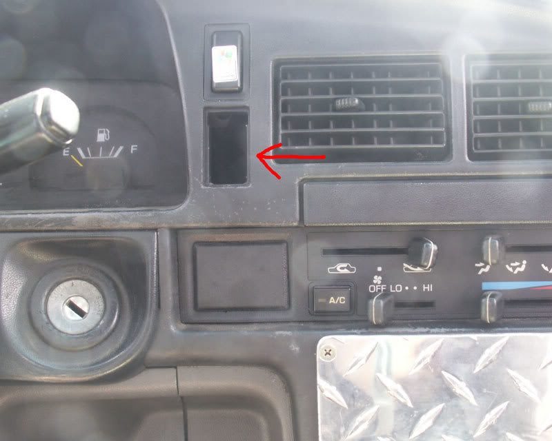

I'm running an e-fan from a taurus on my truck. It moves MASSIVE volumes of air. It's lived through 2 South Florida summers flawlessly so I'm happy with the way it works. Ive got an on-on switch I picked up from a local marine supply place that just snapped into a spot in the dash. I'm getting power from the plug that the factory clock went into. I didn't have a clock so it was just perfect that the plug was there.
