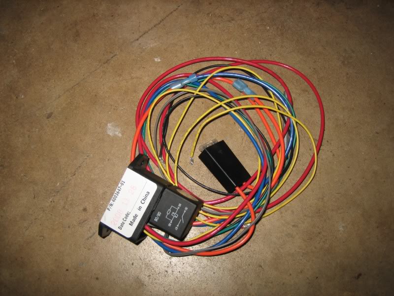

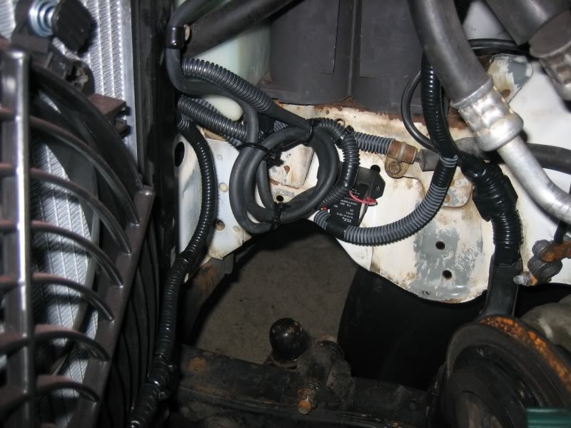

I'd agree on the switch part
you always want to have an over-ride if the thermostatic switch malfunctions
I had a 3-way switch wired into mine
Down was fully automatic; kicked on once the engine reached a certain temp, or when the AC was kicked on
Middle was over-ride off; completely disabled the e-fan
Up was over-ride on; just turned the fan on, regardless of engine temp or anything
worked good for when the AC was on and you were on the highway; no need to have the fan on if your doing 65mph
my fan was not a Taurus fan though; I spent a little money on my setup
