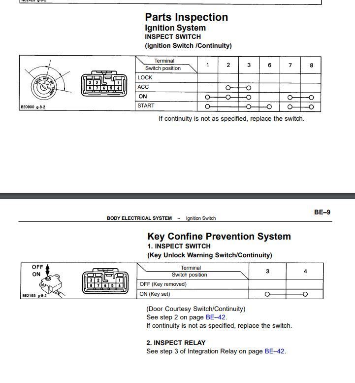

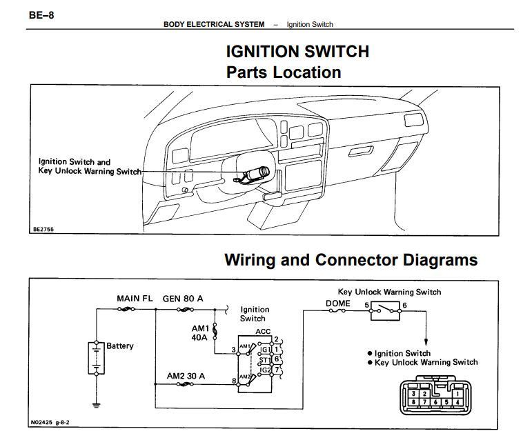

I just had the same problem. Buzzer stays on when the key is out and door is open. The previous info is good, but
Does any one know how to make it work as intended?
Originally Posted by scope103
I'd start with the Key Unlock Warning Switch. http://web.archive.org/web/201102052.../3ignition.pdf
Originally Posted by jvincent57
Thanks, The link you posted has expired but I think I found some good info on Google. Now I just need to find time to get into it. I'll update when I do.
I forgot to mention earlier that I have a 1993 pickup
which link? The one posted by scope103?
Add your vehicle info to your signature (click on user CP)
It worked fine for me.
