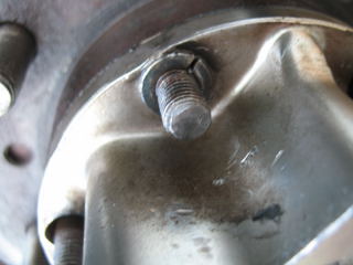

Hey guys....I attempted the screwdriver method and no luck. I couldnt budge it. I got the screwdriver tapped down in gap a good ways and then hit it left and right with the hammer attempting to move it. I also tried moving it with my hands....no luck. those things are in there. I attempted to heat it again and give it a shot....no luck.
I think the housing being a little bent is applying more pressure....not sure but i am attaching the pics...

The housing is definitely pinching them in.
But I found this: http://www.4x4wire.com/toyota/mainte..._end/teardown/
it mentions using a large brass punch and a heavy hammer.

i would try to file the threads down until you can get a couple nuts on...then use the double nut method to remove the entire stud and replace

Replace all of the previously removed cone washers and nuts and tighten to spec and then try to get the two troublesome cone washers out. It'll change the tension dynamics of the hub. Worth a shot.

SUCCESS!!! The Chisel and BFH with a few good whacks b/n the housing and the hub took care of it. I filed the threads, replaced to studs and finished the job!
