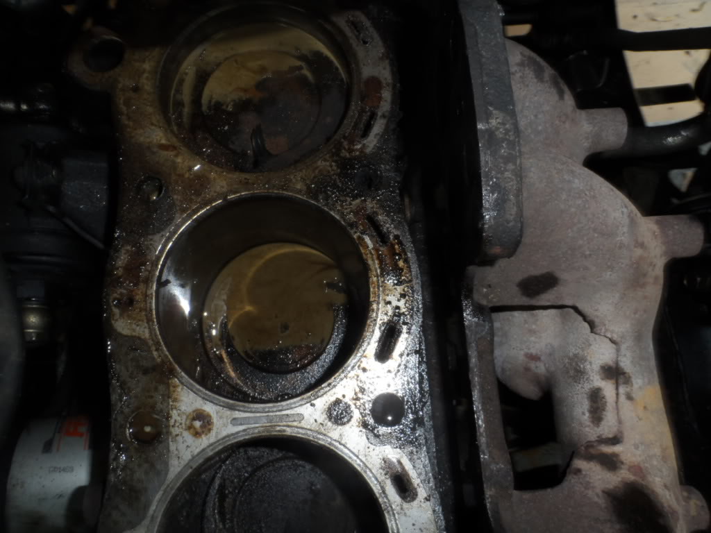

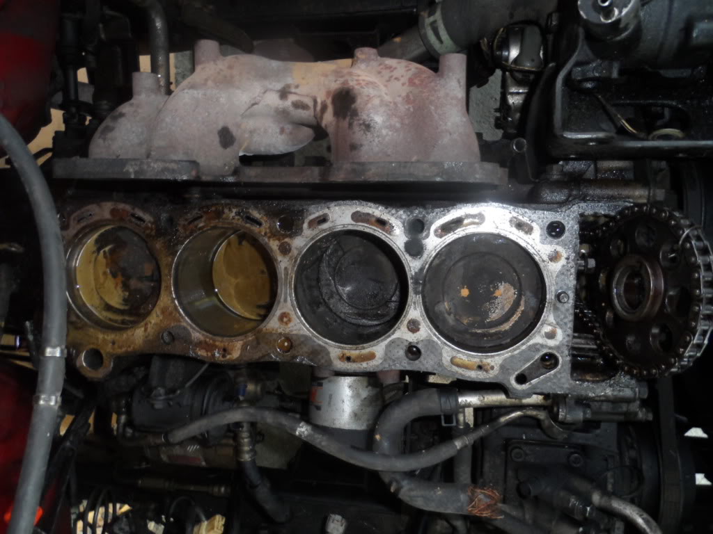

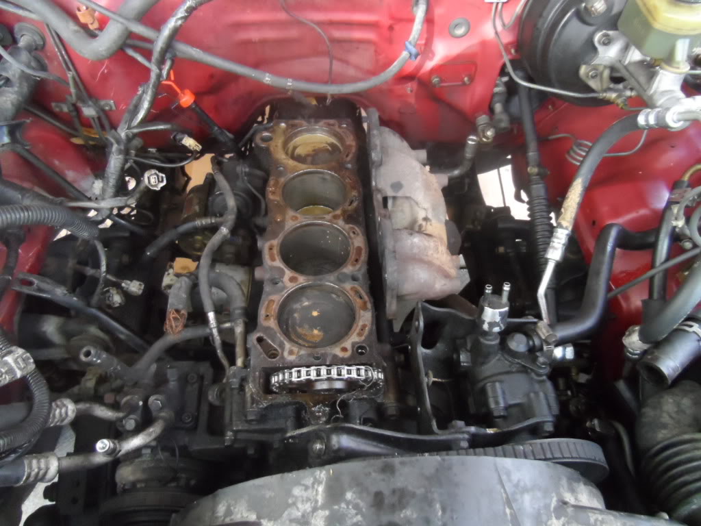

hi i just got this 92 toyota truck auto with 95k miles a week ago and was running fine until sunday when it would shut off after it would warm up took it the mechanic and he say blown head gasket ($1200 repair).

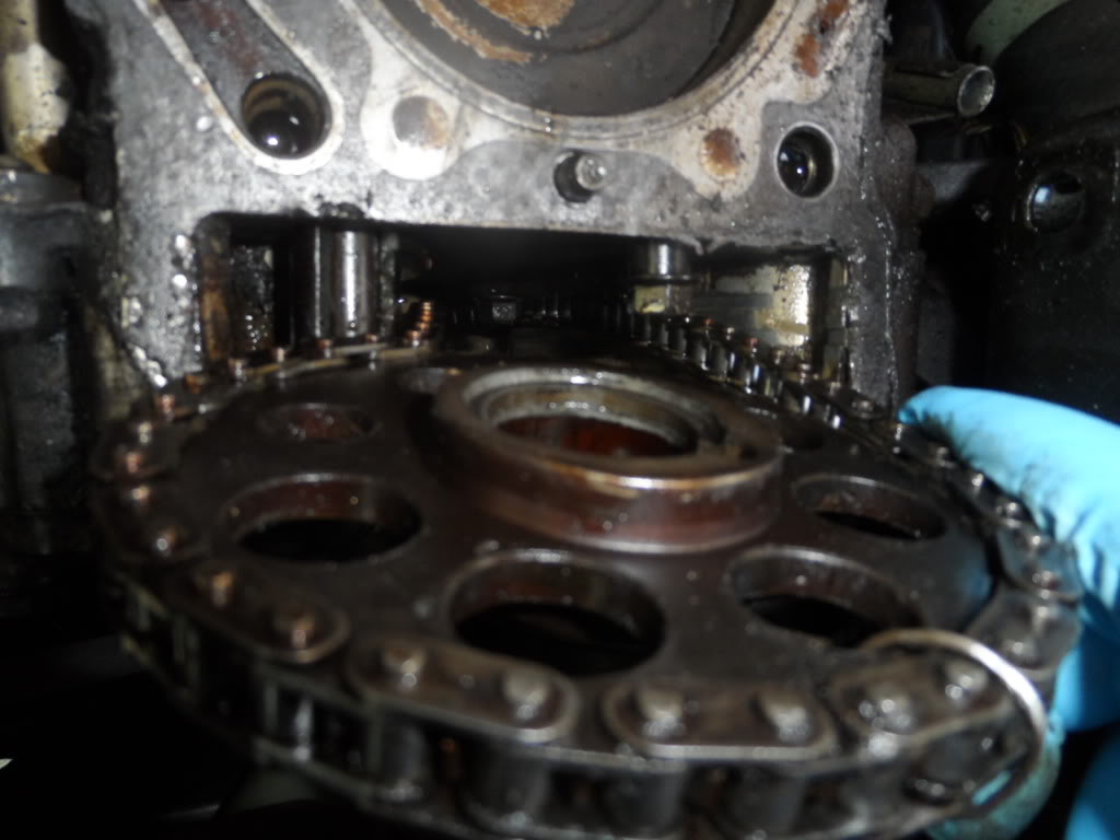

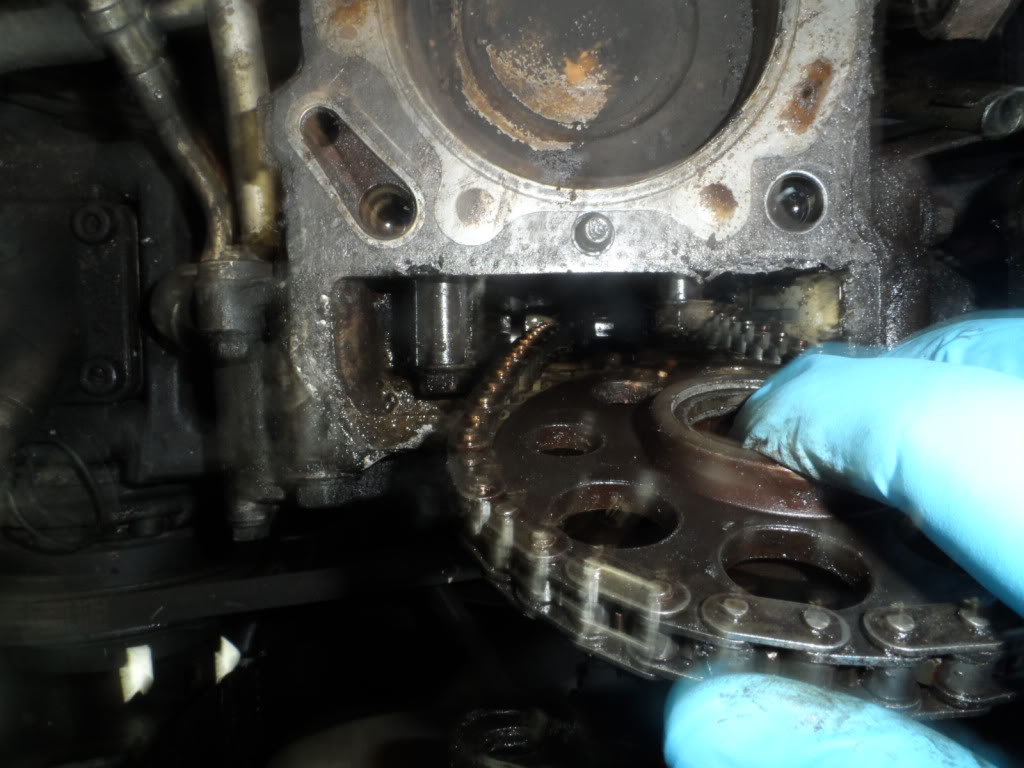

so i take it home and decide to do it myself came on here and found the manual and took it apart but now i hit a wall the chain guide look like they are broken and has a nice groove on the right side (as you look at the motor) from the chain slapping
wanted to know if the broken guides can cause the blown head gasket or the other way around and any other issues before i proceed to buy parts
should i reapir the timing chain and head gasket and hope for the best or buy a used engine for it as i dont know what else could be wrong with it thanks

Replace the timing chain guides. Metal or plastic. The timing chain wont cause the head gasket to fail, nor vice-versa. The guides just wear out. The chain needs to be replaced every 90K-120K miles anyway. Eventually, the chain will wear into the timing cover where those grooves are and rupture the coolant passage there, introducing coolant into the oil. You're already half way to getting the timing set off (head off). You definitely need to replace them.
Old Feb 28, 2013 | 07:39 AM
SCToy's Avatar
Joined: Oct 2009
Posts: 1,560
From: Santa Cruz, CA
Yes its worth repairing. Get a timing chain kit, new timing cover, also a good time to do the water pump and pil pump. Those can all be pretty cheap at engnbldr, get the headgasket from toyota.
