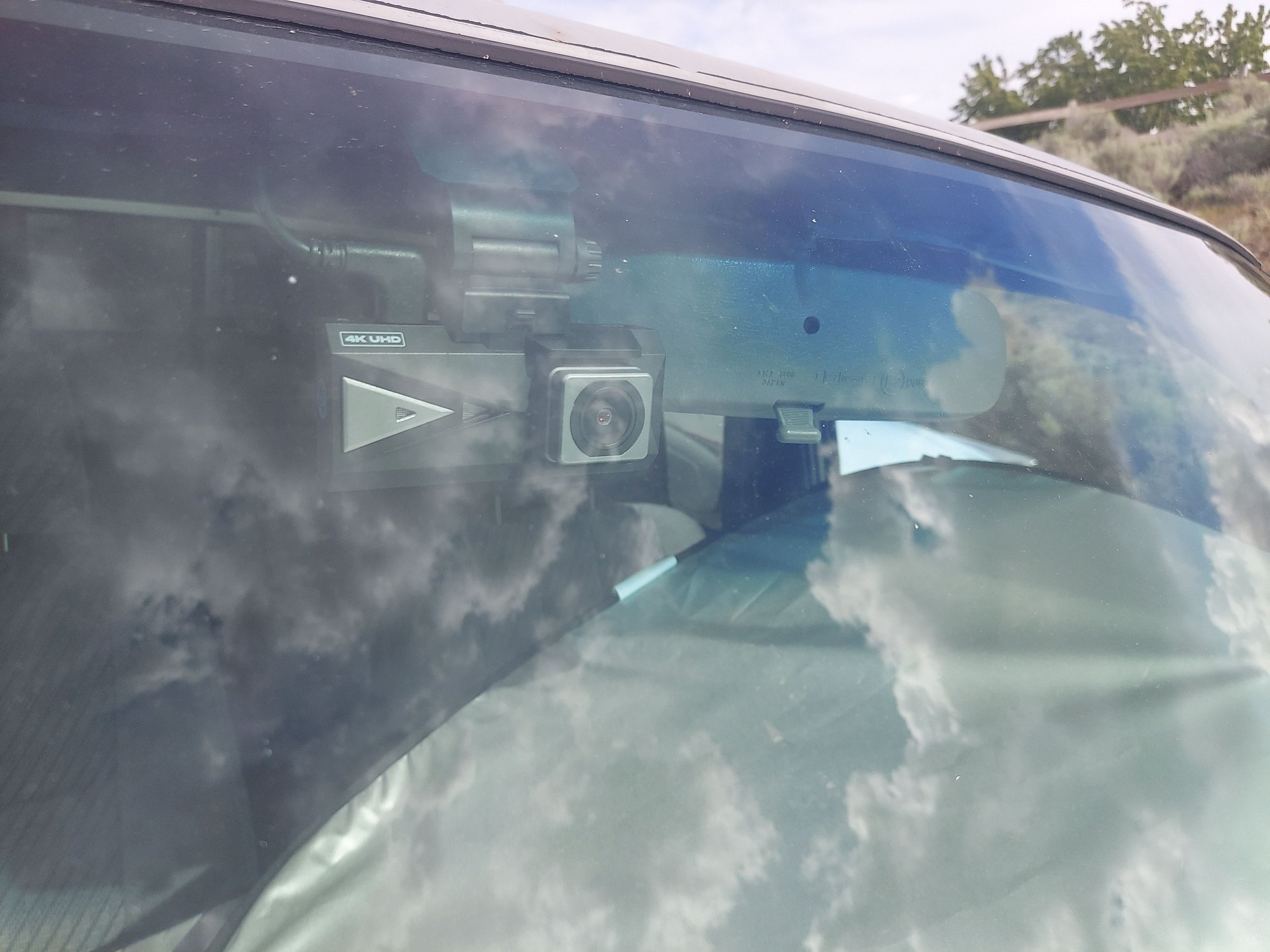

Dash cam
Old Apr 29, 2025 | 03:38 PM
Broady46's Avatar
Joined: Jun 2024
Posts: 8
Dashcam

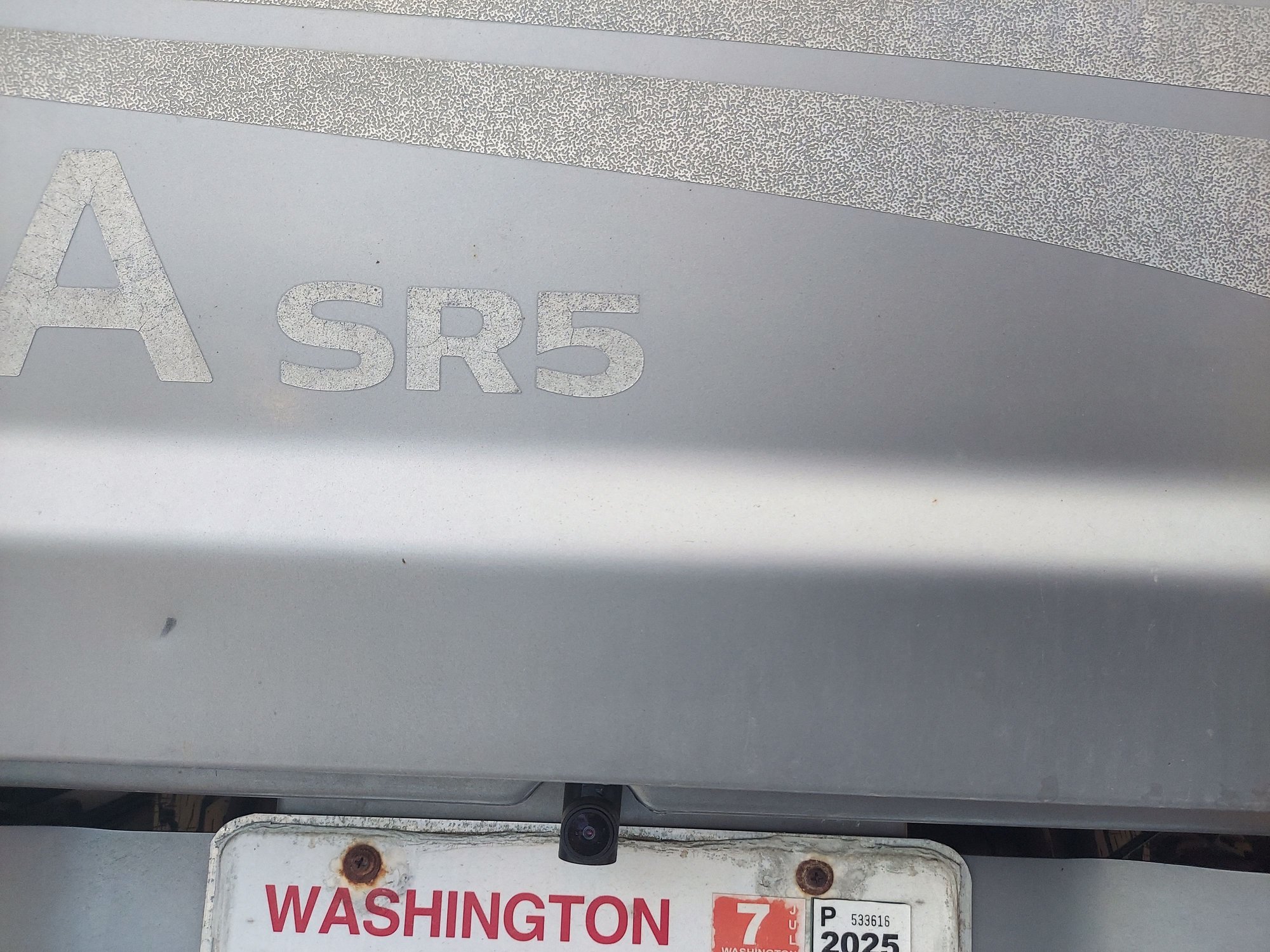

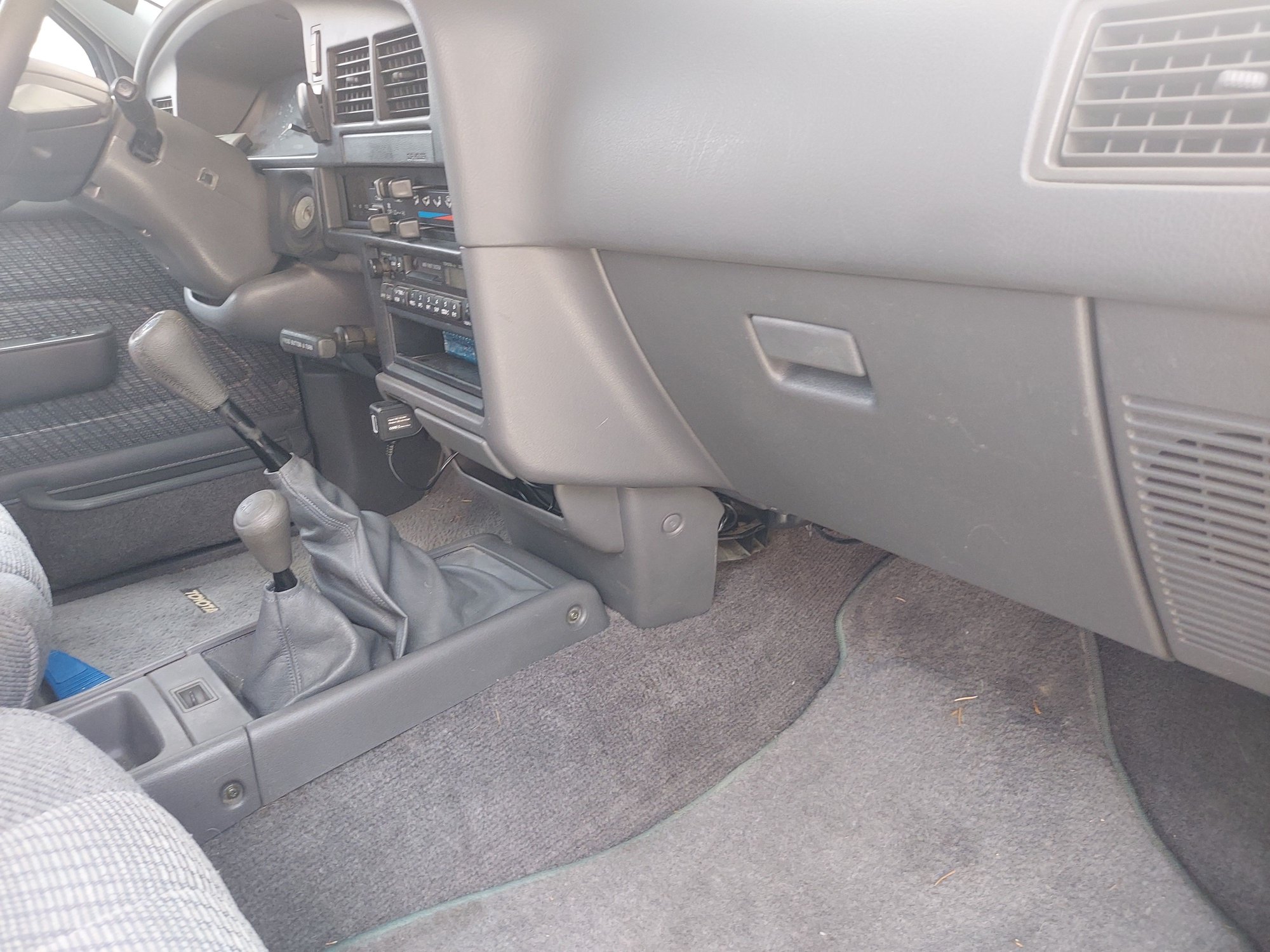

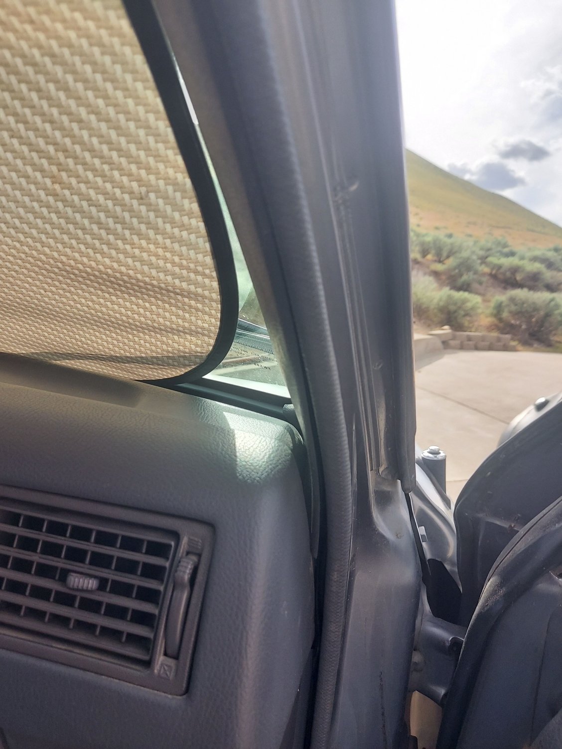

As you can see, both lines (power and rear cam) both went under the vinyl headliner without problem. Use plastic tools. Remove grab bar on A pillar, then remove plastic cover and rubber gasket for door. Hide wires there, then over behind glovebox. I used the lighter power source, though my camera had the shake mode - that requires contaminated power source. Didn't want to bother with that. My adaptor had a USB-C so could still charge phone without unplugging the camera.
For the rear camera, I ran wire below door sill, and went through rubber to underneath vehicle at back of door sill area. Just punched a small hole through and fits tight. For the Actual camera mount, I ended up using superglue for the mount. Seems to work fine and is protected. You'll need a number of zip ties.

Cool....thanks for the pics and I see how you wired the cable through the bottom tray to the cigarette lighter. Did you have to drill a hole in that tray to feed the cable through? By the way, the interior on my 93 looks the same just blue - even has the 5-speed

I don't think I drilled it where it comes through to the lighter, though you could create a little divot for that purpose. Maybe I did, just can't recall.
