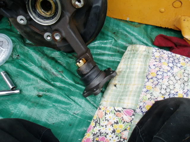

hey man need yur help. Where did you get that new knuckle seal at? Remember the part number off hand? Was that a single piece that went in there or two pieces? Can't tell from the photo, but does that steel dust shield extend beyond the knuckle or sit flush with the hole?
