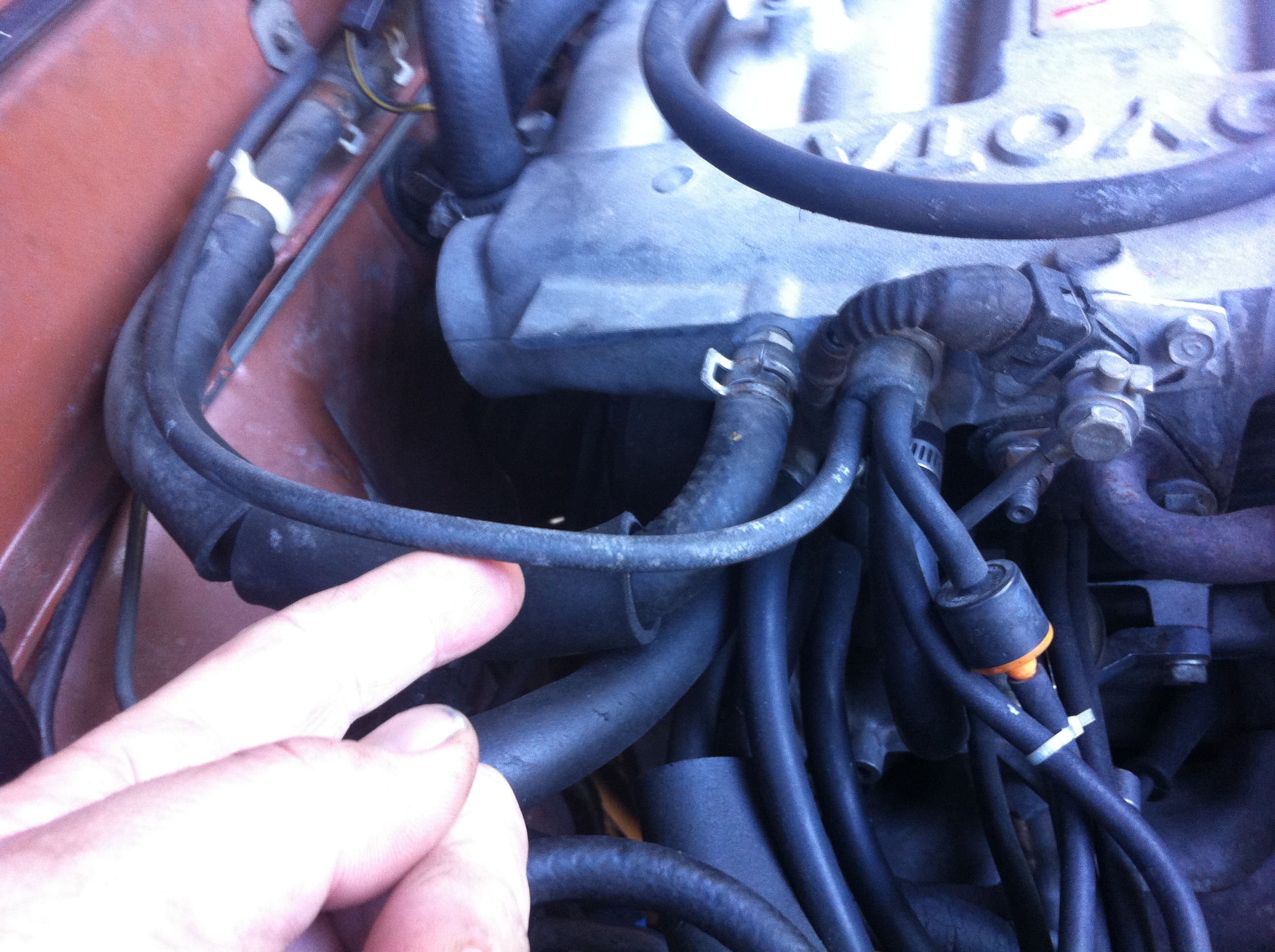

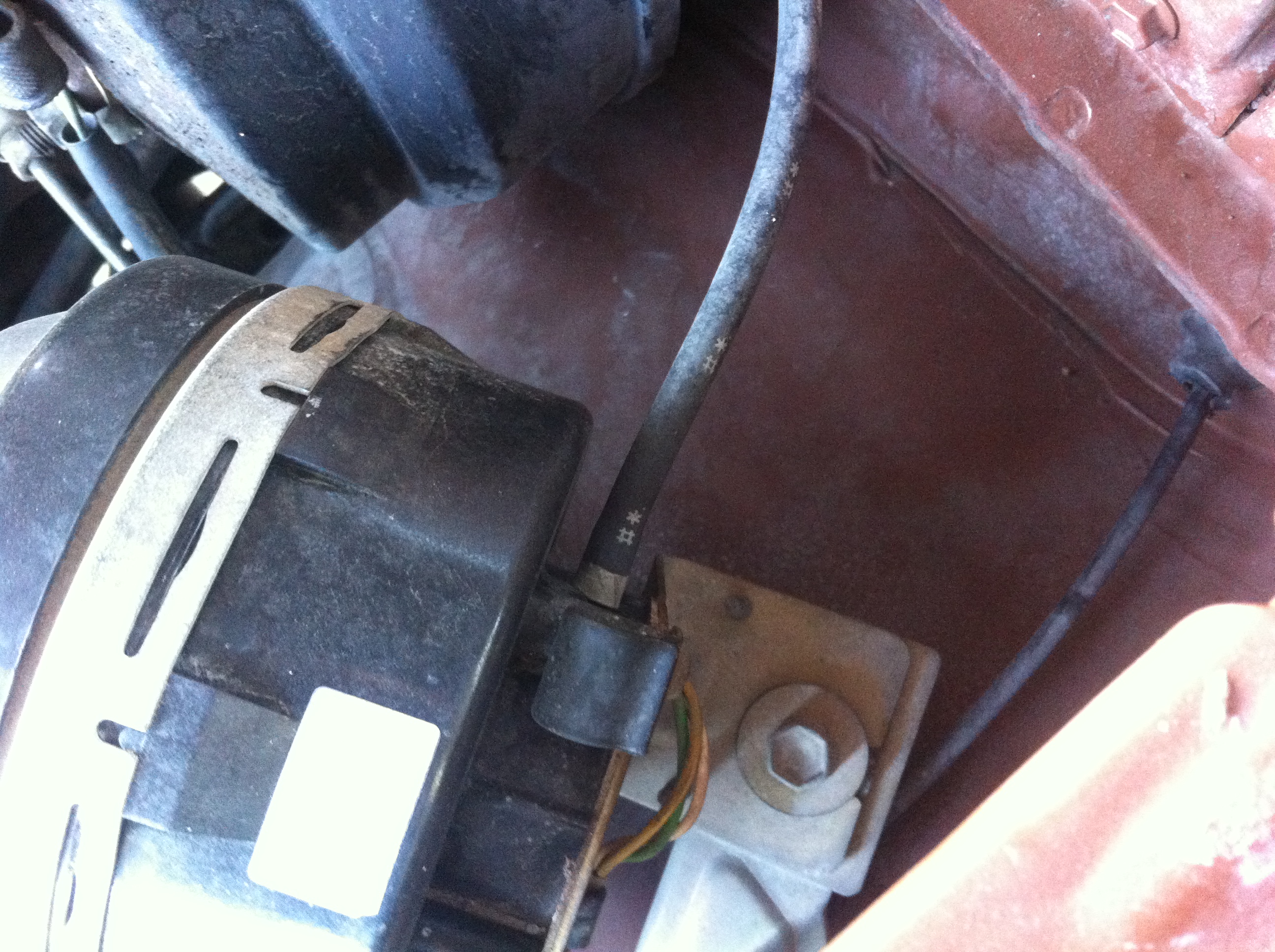

photos of my rig under the hood
Originally Posted by coloradotom
...Any chance you could take a picture for me of your motor with all vacuum lines routed correctly?
Took pics of my cruise control and the hose that runs from it:
Look right?
Old Nov 3, 2013 | 06:21 AM
jacked_72's Avatar
Joined: Aug 2013
Posts: 22
Here's how mine looks on the V6 and where the vacuum line goes into the intake manifold.
Attached Thumbnails Cruise Control-img_1166-1-.jpg   Cruise Control-img_1167-1-.jpg   Cruise Control-img_1169-1-.jpg
