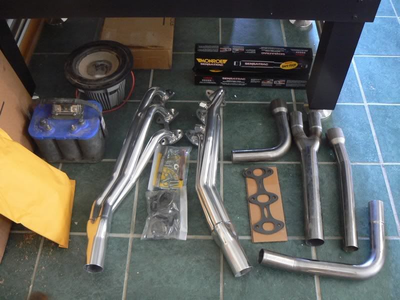

Here's is the ORS custom cross-over, might give you some ideas. It's for a 3.4 and 2.5" IIRC. Note it has a flex coupling, when made without a flex coupling they were breaking rather quickly.

am i missing why you would not put headers on for that kind of money. the only reason i can think of is the PIA install.
I have 429 into my ceramic headers and x-over..
if you make your own, of course, thats a whole lot cheaper and logical
